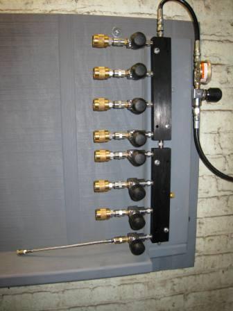

GCSInc
Posts: 246
Joined: Fri Apr 01, 2005 10:49 am
Location: The Ole Mill Range Complex, Griffin GA, USA
OMRC Nitrogen System
Post by GCSInc »
OMRC Nitrogen System.jpg (22.3 KiB) Viewed 6060 times
OMRC Nitrogen System 2.jpg (23.54 KiB) Viewed 6060 times
OMRC Nitrogen System 3.jpg (20.74 KiB) Viewed 6060 times
Chris
