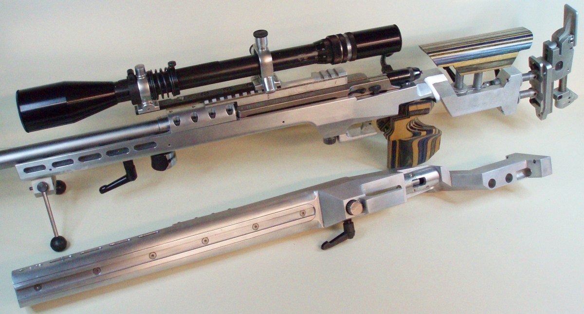

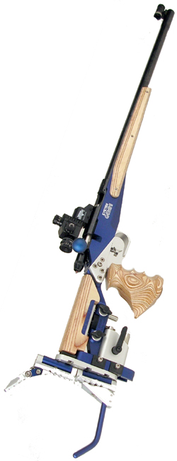

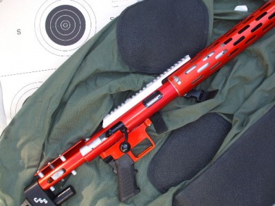

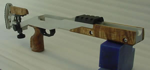

Im own an Anschutz 1813 super match rifle. It has the original 54 action barrel on it as well as the original stock. Ive been thinking of replacing the old wood stock for something with more adjustments like a sliding and cantable cheek piece as well as the ability to move the entire buttplate left or right. Ive seen models by Ross precision, Competition shooting stuff, intershot, and Jeff madison.
http://www.rossprecision.com/products_stock.htm
http://www.accurateshooter.com/stocks/r ... -in-tuner/
(Jeff Madison stock)
http://www.competitionshootingstuff.com/id14.html
http://www.intershoot.co.uk/acatalog/Rifle_Stocks.html
(System Gemini)
The stock needs to follow all NRA, NRA International, USA, and ISSF rules. It also needs to have 3-p capabilities. Any other suggestions or recommendations? Please feel free to ask me any questions or put a different stock out there.
Intershoot model : System Gemini
Competition shooting stuff model : AN-1
Jeff Madison stock
Jeff Madison stock
Ross Precision Stock

Voted Gemini. With Ross as second place. Didnt like the AN. Looks more militairy with colour than target..
RobStubbs
Posts: 3183
Location: Herts, England, UK
Post by RobStubbs »
Well my 1813 is in a Gemini stock so that gets my vote. But that's because it fits me very well and adjusts pretty exactly as I want it to. I would have preferred the Walter anatomic but it just proved impossible to buy.

Madison hands down, the best.

for me, Jeff Madison's stock is the most interesting due to the inbuilt tuner. Endless scope for fiddling...
Ken.

The pictures i posted are ones that i looked at and were interested in. I dont want the precise stock because my friend went to Perry last year and had to shoot prone with his off hand block in front of the trigger guard because the officer deemed the trigger guard unsafe due to the fact that it isnt a complete, wrap around guard.
price is not an object. I want to get different opinions on what i saw (and posted) as well as other ideas and possiblities.
I dont care about looks, i care about the capabilities of the stock. I do realize that many world cup and top shooters around the world use the anschutz wood stock. But for 3P, im quite limited to what i can do to make the rifle fit my position.
im 17, 5' 11'' and weigh about 190lbs (im a lazy rock). I AM STILL GROWING (keep in mind). I have large hands with thick fingers. my trigger finger is 3 inches from the knuckle and my thumb is about 2 1/4 inches from the knuckle. The circumference of hand is 8.5 inches and my hand span is exactly 9 inches. hope this helps
Thanks for the input guys! keep posting
Again, feel free to express your opinions about other stocks as well. I am open to try any one of them.

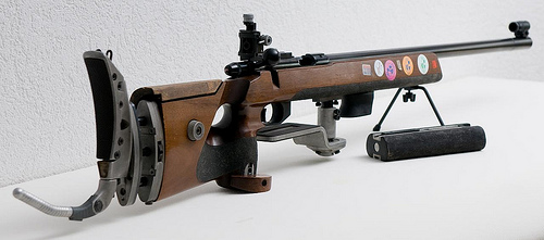

BAtarget
This is not my rifle. I own this type of stock with the original 1813 supermatch action and barrel
BAtarget
Posts: 51
Joined: Wed Oct 12, 2011 3:19 pm
Post by BAtarget »
the buttplate in the above photo is the same as mine.

I have Jeff Madison's stock. It is excellent. There is no comparison between his craftsmanship vs the cast aluminum of the German stocks. When you look at them side-by-side, it is stunning. He is a real pro.
Best,
Michael Bradley
