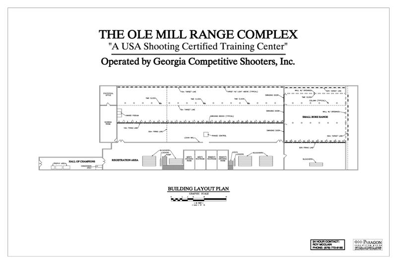

The Ole Mill Range Complex, Griffin GA
Range Layout
- Copy of 2012 The Ole Mill Range Complex (Medium).jpg (44.64 KiB) Viewed 9593 times
