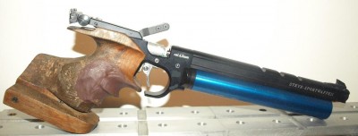

Post by LukeP »
Thanks Ken4all, good Fimo advice! Works Great!
Gave it a test today, here the result. Nice feeling and cheap, grip not suffered from 110° exposure, fimo hardened as wood.

Luke, is that the Morini trigger blade (for long finger) on your LP?
