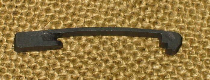

Here is the Model 39 extractor I got from Numrich. Apparently, the only way to remove the extractor is to push the claw end out of the slide and move the extractor rearward. This is something that I'm not going to try unless it becomes necessary.
The only difference that is apparent without removing the original is that the claw is thicker on the 39 than on the 52. That's the barely visible bump on the end of the extractor. I guess this makes sense if the rim of a 9mm is thinner than the rim on a .38 spl - I don't have a 9 here to compare.
So if there are any 52 owners out there who want a replacement or a backup, this looks like it will do the job with just a little bit of modification and Numrich has more.
