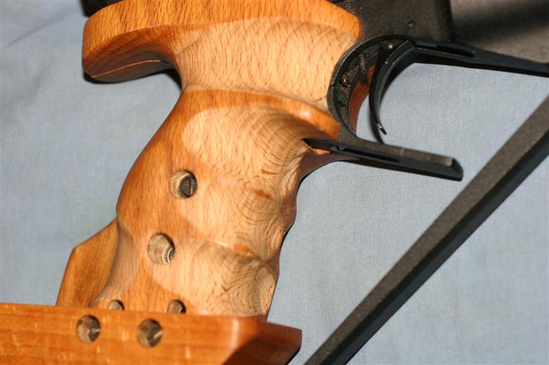

To agree with what was stated above, most of the IZH46M versions that I have seen in the last few years had an extra meaty and thick grip in order to allow for customizing the fit. The original IZH46 in comparison did have much thinner less hand filling grips and were a bit of a weak link on an otherwise great gun for the money. My hand is a somewhat chunky medium size and I found the M series grip too fat for me until I took my dremel and file to it. I have attached a photo of the results. These are still one of your best values for good performance and reliability and certainly are well able to produce top scores if you are doing your part.
Joe G.

I have had an Alfa Proj pcp with adjustable palm shelf grips for about 8 months now, got it in a trade/sale of one of my match pistols. It is a nice gun and a fairly good value but for me I would prefer an IZH46M for ten meter shooting. Out of the box without the supplied weight that can attach to the barrel shroud the Alfa seems too light overall, again a personal judgement. The weight supplied seems a bit too heavy in my opinion, and I do prefer my match pistols with some forward weight bias (another reason I like the IZH's). Perhaps I haven't tweaked around with the Alfa's trigger enough but I have the triggers on both my IZH46M and original 46 much closer in feel to my high end ten meter pistols' triggers. I also find the Alfa's grip to be a tad too upright. That said the Alfa is still worth checking out if you can get your hands on one and decide how you like it. I have relegated mine to be a metallic silhouette shooter where I think it will perform admirably.
