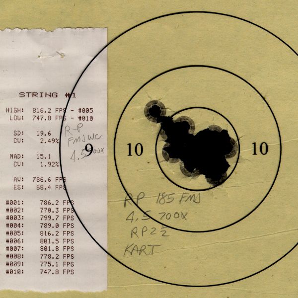

fc60
Posts: 757
Remington 185 FMJWC Accuracy
Post by fc60 »
Greetings,
Attached is a scan of a group fired at 50 yards.
