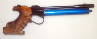

Hi Guys,
I have been offered this Morini but not sure what it is, the seller is claiming its a Morini 162EI but it doesn't look like one of the new ones? If its an older 162ei what are the differences between the older model and newer one?
Brenton
j-team
Posts: 1386
Post by j-team »
That looks like a 162e (before the 162ei). An early one with the fixed cylinder (the "e" is for electronic and the "i" is for interchangable). That's assuming it's electronic, if not then it's just a 162.
OK if you are getting it cheap and don't mind screwing the whole pistol on to your tank/pump to refill. It should have a little cover for the filling "nipple" at the front of the cylinder.

How much are the older ones worth?
Posts: 1719
With the age of the old fixed cylinder, think about the kit to convert it to a removable cylinders with two new tanks.
These are available from Morini.
The cylinders have a fatigue life of 20 yrs.
ghostrip
Posts: 426
Location: Athens, Greece
Post by ghostrip »
you can always change the cylinder without reverting to interchangeable ones. it should be much cheaper. the previous owner of my 162e had it serviced at gehman's. prelutec also has cylinders for 162e http://www.prelutec.de/produkte/produkt ... -mo-e-rot/ . In both cases it must go in to the factory (gehman/prelutec) in order to change and verify its good operation. the conversion kit would cost about 350 euros and it includes 2 cylinders. n general good conditioned 162e like yours in egun cost around 550-600 euros
