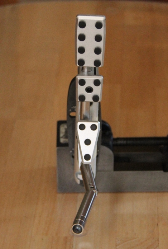

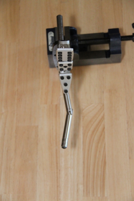

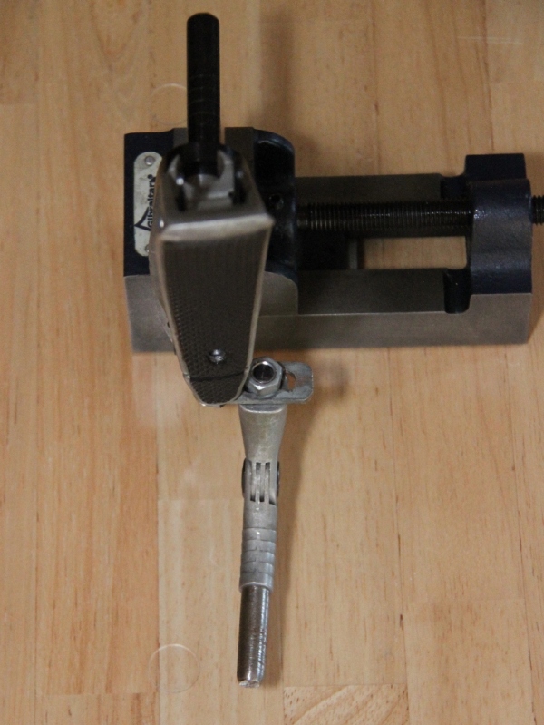

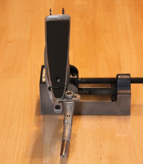

Grizzly,
A few thoughts from my own experience, first the disclaimer, on and off I have shot for about 40 years with everything from the rubber puck, and the fixed “one size fits all 60s vintage Anschutz hook to these days a MEC Free Position. Sometimes I think the most comfortable butt arrangements were the rubber puck borrowed from a 1407 attached to the back of a 1413. The hardware setups available today make it difficult to do that anymore.
I have approached the “butt hook in prone” with the theory that the better the hook fits the shoulder the less variability in its location there will be. In studying the hook and the shoulder problem the issue I have always had with the hook was that it seemed to come out of the buttplate at the wrong place. If you look at most hooks, everything is done on a vertical line. The MEC Free Position is this way and the TEC-HRO (Fusion?) uses a similar design. Very two dimensional.
The problem I note is that my shoulder is not built on a straight line. On the shoulder there is the crease between two major muscle groups where the buttplate naturally wants to fall. For me this crease does not line up leading directly to the armpit. I have always felt the hook needed to be offset to the right (yes I am a right handed shooter) some small amount for the plate to fall naturally in the crease of the shoulder and the hook to fall in the apex of the armpit. This cannot be accomplished by simply swiveling the hook.
On and off I have tinkered with the hook in three dimensions where it can not only swing but slew or offset. I have attached pictures of an Anschutz plate I modified about 1984 with a stub hook and the hook offset to the right. I came to the conclusion the offset was about twice what I wanted it to be with no way to make it smaller. This enters the picture of the current setup on my MEC where rather than having the hook scoop upward I have it set to swing out right then left, somewhat accounting for the difference between the crease between the muscles in the shoulder and the apex of the armpit.
I don’t know about the adjustments of the hook on the TEC-HRO you are using. It looks like you might be able to work it with an offset right where the hook is attached to the main assembly. Perhaps there are some points to be gained there.
Hopefully this gives you some ideas for a line of investigation.
As a side note, Interestingly, I see that Maennel has a buttplate that will do almost exactly what I am talking about. Not that I am going to run out and buy one today, or tomorrow, but it is interesting to see this adjustment is commercially available.
‘Dude
