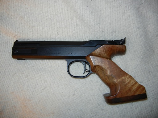

I had to get some parts for one of my AP604's a few years ago and the factory was very helpful. I contacted them via email and they sent everything I needed. When the package got lost in transit they sent a second package of parts out. Great little gun, the only duplicate I have in my collection, can't bear to part with either one.
Joe G.
