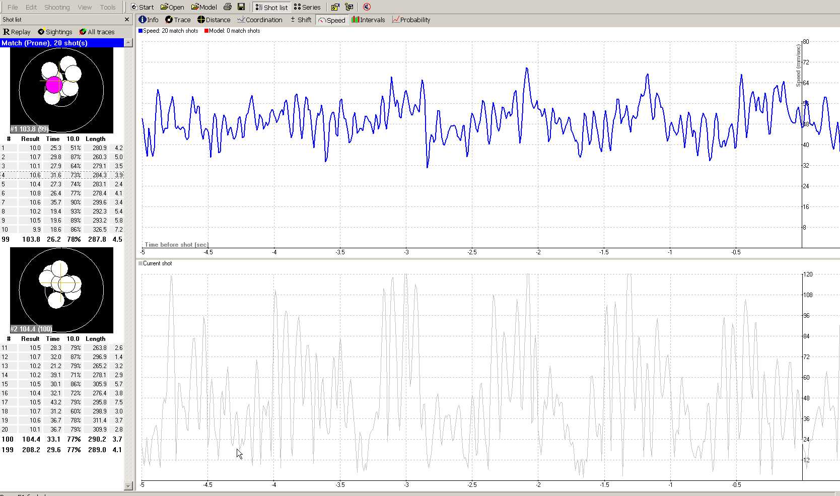

How do you deal heart beats and how can you shot beetwen them?
Last days I was trainig on my Scatt sistem and I realized that if you could shot exactly beetwen heart beats you have bigger results.
The problem is how can you feel the heart beat?
What should we do to know for sure which is the righ moment to press the trigger?

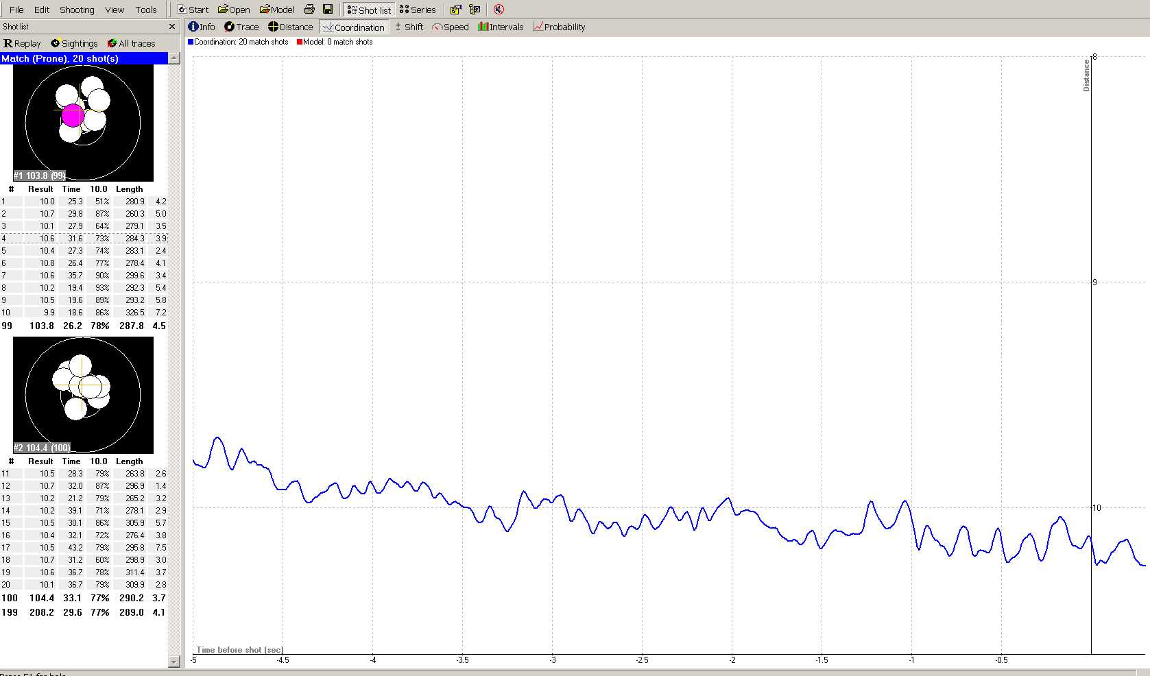

As you can see in the two print screen below (are for the same shot) the speed and the coordination are strongly linked together. So when the heart beats the rifle is accelerated, the speed rises, and the coordination, I mean orientation to the center target is disturbed.
So the heart is a problem.
Thank you.
Thank you.

If you are shooting from prone position, I do not understand why your length scores are as high as they are. If there is a lot of artifact on your tracings, this could be related to halogen or incandescent lighting near your setup that is causing signal distortion. Flourescent lighting can eliminate this. If so, you will see a sawtooth pattern on your tracings.

First of all thanks for your quick answer.dlinden wrote:If you are shooting from prone position, I do not understand why your length scores are as high as they are. If there is a lot of artifact on your tracings, this could be related to halogen or incandescent lighting near your setup that is causing signal distortion. Flourescent lighting can eliminate this. If so, you will see a sawtooth pattern on your tracings.
Dennis
This proves what a pasionate community are you. I am very glad that I can join your community.
I am not sure that I understand very well what are you telling me (maybe my english is not so good), but as far I can understand I can answer yor question.
My "lenght score" - here I can understand the tracing line- is so high: 287, 290mm because I set the control interval at 5 sec, so the yellow line is the last 5 sec before the shot.- normal the media is at 55-60 mm/sec.
If I am wrong with the understanding please let me know.
But is very intersting what are you saying that the fluorescent lamp is not disturbing for the signal. I have a light source the incandescent one, from a Rika wall support. When I will have the opportunity I will try with fluorescent lamp. About the sawtooth is not present.
The original file is attached here for the ones who want to see it.
(The date is wrong due to my laptop settings)
- Mihai Axinte 17-04-09 17-52-55.scatt
- shoot on 17.11.2010
- (57.42 KiB) Downloaded 154 times
Well i wouldnt be worried about your pulse at this point. What you should work on is your Natural Point Of Aim (zero point). It seemed on the majority of your shots the zero point was too high. You should work on getting your apporach correct. by this I mean your trace should start at 6 oclock and rise up to the center and settle right before the shot breaks.

westerngriz wrote:Well i wouldnt be worried about your pulse at this point. What you should work on is your Natural Point Of Aim (zero point). It seemed on the majority of your shots the zero point was too high. You should work on getting your apporach correct. by this I mean your trace should start at 6 oclock and rise up to the center and settle right before the shot breaks.
Matt
I thought that is because the sighting. I did not pay attention the sighting shots very much because I wanted to control the triger release beetwen heart beats.
If I understand the zero pont is the center of the target right?
Thanks for your comment.
