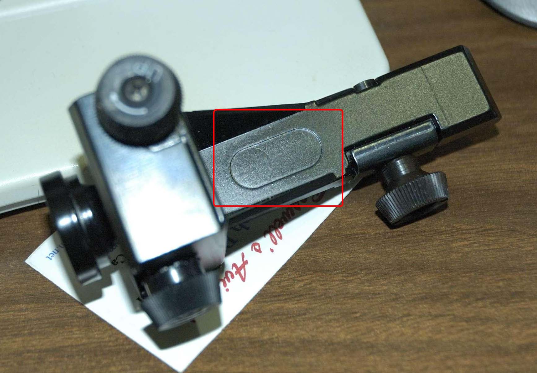

How can you tell the difference? .....
1) Older Gamos had an embossed oval on the rear sight just in front of the diopter that had "Gamo" inside the embossment
2) Current Gamos have the embossed oval, but no text
3) cheap Chinese garbage sight has no embossment at all, nice flat glossy top
(one day I'll take pictures.....)

This is the top view of my rear sight showing the embossed oval that jbmartin mentioned in his post.
