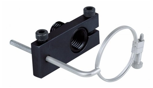

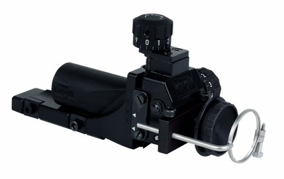

Anschutz does manufacture a lens frame that can be attached to the rear sight, but as 'Dude mentioned, against ISSF rules. So, if shooting matches that aren't shot according to ISSF rules, why not try it? Just check the applicable rules first, though.
Pity though, don’t really know what advantage a corrective lens fixed to the sight would give you over someone with perfect eyes. Having poorer eyesight already disadvantages you, then add a shooting frame with even more complexities. I don't know anyone with perfect eyesight that has to live with the complexities of shooting glasses. But, hey, the rules are the rules. Perhaps someone can explain why the lens must be worn by the shooter? I would find it very interesting to know the reason.

I am attaching pictures of the lens. If looking at this frame and how it is attached, I fail to see how having this specific lens frame on the rifle will give a shooter any advantage over someone with perfect vision.
