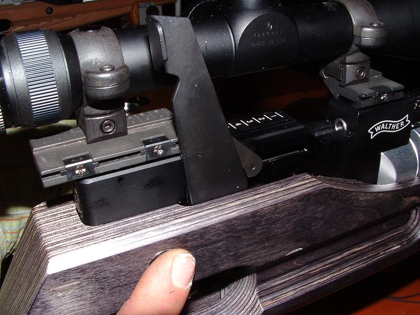

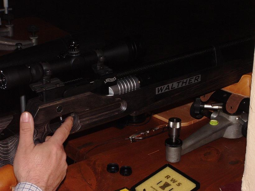

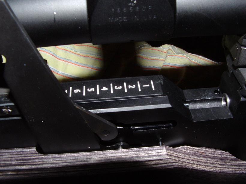

Post by henry1 »
here is some pictures of the a walther air rifle set up in a brenchrest club in germany

Post by topclass52 »
my issue is not scope body clearance (I already turned the scope 90 degrees and switched the turret knobs to avoid this interference), but clearance from the rings themselves as the lever on an LGM1 is exceedingly long. And with dovetail only behind the loading port I cannot mount a second ring without preventing the loading lever from moving to its full and upright cocked position. I don't have this issue on my 300 Dominator (like the one pictured from Germany) as it as a dovetail both in front and in back of the loading port.
