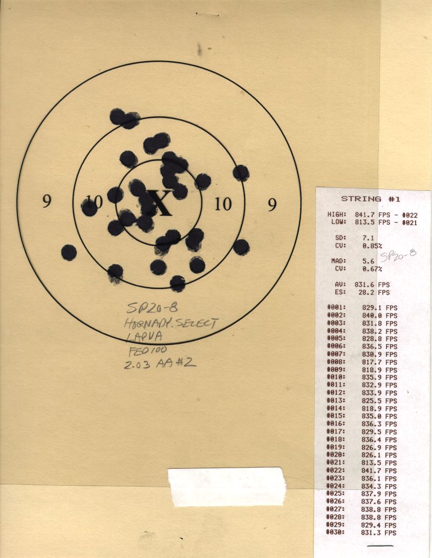

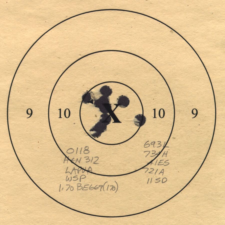

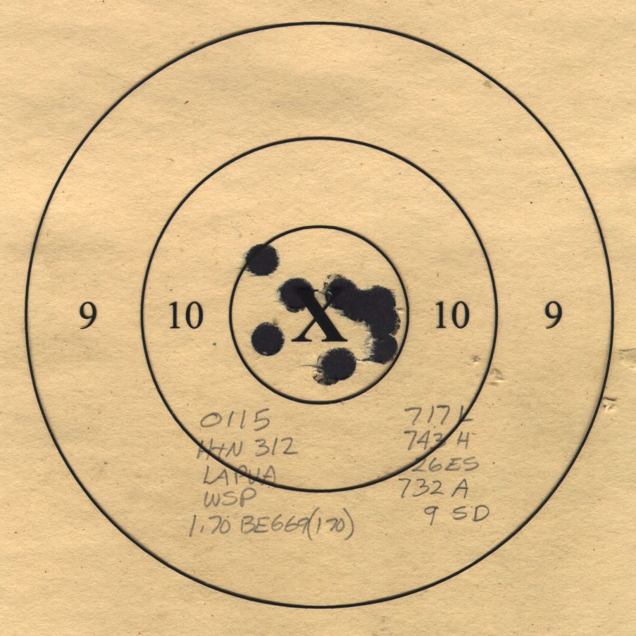

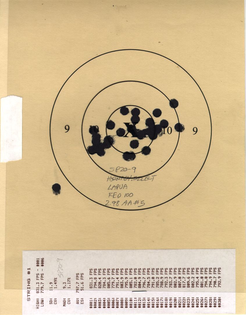

I just finished up two Pardini HP barrels and mailed them off. Currently, I have material on hand and no major projects pending. So, this would be a good time to have me machine a new barrel for your Pardini, Walther, FAS, Hammerli, Benelli, etc.
Attached are sample targets fired from a machine fixture at 50 yards.
Contact me off line if I can be of service to you.
Dave Wilson
Fabricator and shooter of fine 32 barrels.
This barrel is en route to Illinois.
This barrel is on it's way to New Hampshire.
