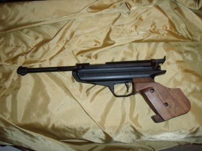

I traded my pardini K58 for a mint FWB model 80.
He got a much better deal.
He got the gun and case with extra sights manual and original warrarty card.
Win some lose some.
First I think the Pardini is much better looking in person.
More modern looking and very accurate and the Velocity spread is very tight by that I mean not more than a few FPS. The Model 80 is very nice looking also but what I like about it is the feel and the history of it that goes along with my FWB 300S. They were great in their day and still can shoot better than I can manage.
I hope I am ready when a FWB 103 pops up.
David[/list]

Congrats on getting the FWB 80.
I also own the 80 and it is an excellent pistol.
The only shortcomings that i know of this pistol is the upper front muzzle heaviness and that the white piston and bumper seals are made of a cheap synthetic that softens and cracks over time even without use!
However, the blue breech seal is very durable and will last you many years.
If you're interested, let me know, I have the the exploded diagrams for the 80 and 103 also the P34.
Kevho

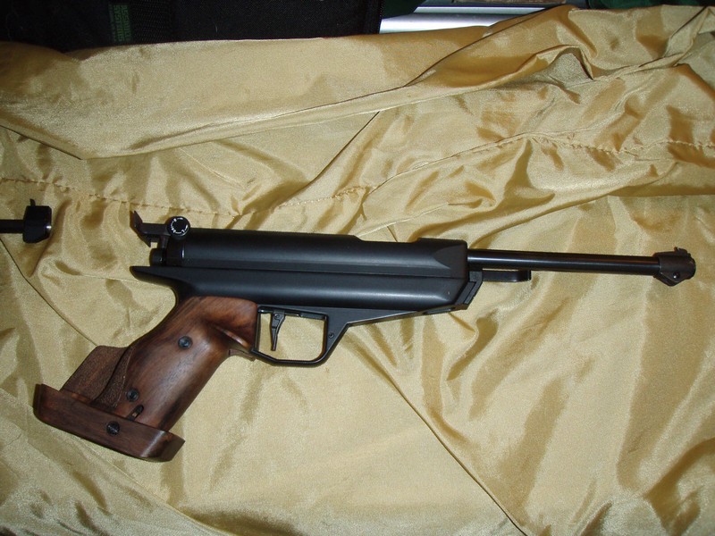

When you cock your FWB 80, the breech will open and you can easily see the piston going back and at the same time you can observe the piston
seal's condition. If there is a deep indentation that is not normal on the seal, you have to change it. (I usually take a toothpick and slighty poke the seal to see if its hard or mushy). The bumper seal is easier to diagnose.
I also see that you have the Izzy, good combination.

OK-I cocked the pistol and looked in and it was not pretty.
Kind of ragged hole and I took a pointed kaboob stick and poked it and it was very soft.
So looks like I should change them.
