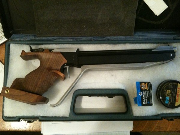

The deal with the trade fell through because I saw an ad in guns america for a K58 for $399 but no pics so I started second guessing the deal and the other person got mad and does not reply so I just might relist it again. Maybe I should say I want to trade with cash for a PCP. It looks exactly like this. http://www.straightshooters.com/Air%20A ... arget.html
Even the color is exact.
except mine has a steel bolt and multishot magazine and a LCD on the end made for this rifle to make it quiet.
I will have to think about it for a couple more days before I do anything again.

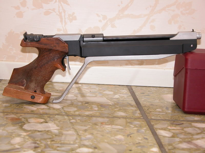

IS this a newer or older K58
I passed on this gun but I should have bought it.
It looks newer. look at the front near the breech on both of them.
I thought they were all the same.
David
David
They're both old. The later models have a dry fire switch below the breech on the right flush with the frame. Same deal with a K60. It is operated by a hex wrench.
Don Nygord occasionally installed these switches in older guns.
Also, I have seen many of these guns without the sliding barrel weight. I don't know how they were originally shipped.
