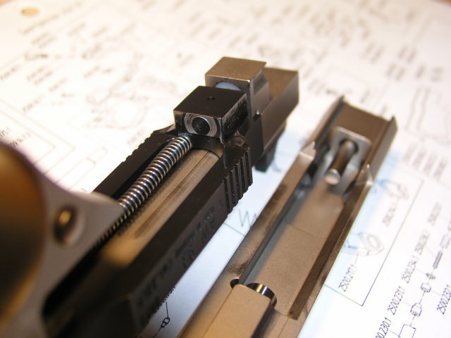

But I'm mystified by the original reason for this thread. There is no rubber buffer at all in the AW93 recoil absorber - it's all done with springs. The only synthetic working parts in the entire action are two white plastic (nylon? teflon?) guide bushings and a bearing shoe mounted in the slide and none is subjected to any impact loads. Are the "few users" dry firing onto the red plastic chamber insert/safety flag and breaking that up?

I can't speak to the maintenance question #1 because I've got the older version, but like bjsulla I keep the damper clean and lightly oiled.
As for #2, I believe the light absorber is intended to quicken the cycle re ISSF rapid fire use now that .22 Short RF pistols are a thing of the past & if that's what you're shooting the main reason to prefer it. Basic physics would suggest that a heavy absorber would beat up a rubber buffer more than a light one.
The slide is really flying when it hits the damper - you can plainly see in the attached pic why a soft insert might be thought a good idea - but I don't know of any actual reliability issue arising from battering without one.
