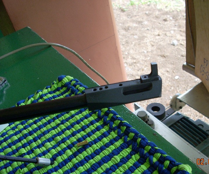

I have a 3 piece release mechanism on an electronic trigger. It has misfired but I think it's because the trigger weight was too low, the screw was practically all the way. I've increased the tension and have not gotten again a misfire yet (and improved my score too though still get my wildshot).
Exchanging notes with another shooter in the forum who was getting misfires (don't know if a 2-piece or 3-piece), we figured out how to dismantle the bolt to clean it. It's not in in the manual and it benefits greatly from the procedure. I had to clean mine out when the loading lever would not close (lent the pistol to another club member who turned white when the lever would not close thinking he had broken it). It's easy to take out with 2 pins and after cleaning and sparingly applying Moly grease in the right spots makes the movement very nice. Post cleaning, both or our pistols work just fine.
There are also two types of comps out of factory. The blue one on the website and one that looks like a black squashed potato. Have no idea in terms of differences in performance or weight. All of the MG5s at the club have my type (potato) which I am very happy with. The side plate on the switch seems to have 2 types too. Mine is like the website, ie without decals. I've seen in phote one with decals from the US. No big deal, I could figure out the "on" and "off" positions.
Save for the cleaning (which is not on manual) and the misfires which I solved by adding a little more weight, I m a happy guy with mine.
