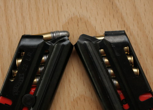

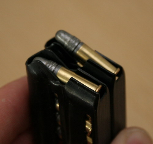

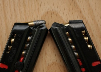

The problem might be related to the loading of magasines. When loading a SSP magasine, it is important that the ammo is in "zig zag" in the magasine.
The left magasine is loaded correct
The left magasine is loaded incorrect

I think TB is on the right trail there. Had the same problem some years ago with one of my Pardinis, was exactly that - rim of the 1st round went behind the 2nd one's, so instead of going forward and up, it gets slammed downward into the ramp.

I have had that problem before in my Hammerli 280 in .32S&WL (slide didn't go forward at all). I always make sure the top round of in the Walther sits proud as in TB's photo but the culprit is usually the second round.

The problem you have seen will be resolved by loading the magasine as TB described.
The pictures TB provided was some pictures i took shortly after i bought my ssp, about 2 years ago.
