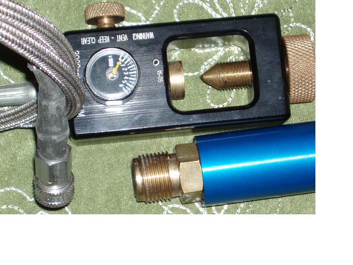

Hi,
Can anyone help me connect my scuba tank to to my Kite?
Pictured is what I currently have.
Thanks!
Vin
p.s. cheaper would be better :)

I don't think anyone offers an adapter that will connect to the screw termination on the hose that is part of the yoke you picture. The least costly direction would probably be to buy the K-valve to DIN 200 yoke that our host Pilkguns sells for $55. This would have the female DIN connection you need to attach the adapter from the Kite. It is a simple yoke without a bleed valve or pressure gauge but it works fine enough. Otherwise you might seek out one that gives you the same connectivity but also has a bleed valve and gauge, either new or second hand. You might also check a dive shop but anything they have will probably be more expensive. Best regards, Joe G.

Post by Fred Mannis »
