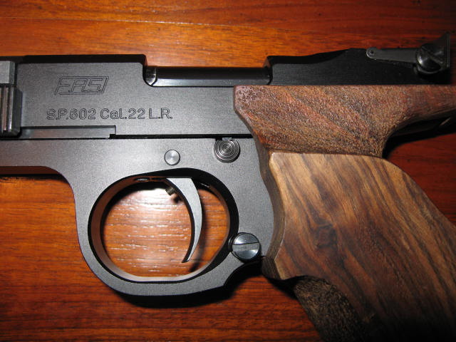

Two pics of 602 i'm evaluating: magazines, trigger blade and hold open button no wear, also screws head untouched .

LukeP wrote:For the trigger assembly screw, i found an old topic (maybe Warren?) describing the way to solve it: changing the screw with a different head.
That was probably me. The problem with the domed head socket screw is that it takes a smaller key than the standard head. It can therefore be difficult to tighten it sufficiently without rounding the corners. The problem with the standard head is that it is slightly too high and can rub against the underside of the slide. A few strokes with a good file across the screw head solves that. You then have to be careful because the larger key size can let you over-tighten the screw; use common sense.
Those pictures do look like the 602 is in fantastic condition. The first signs of wear would probably be on the slide just at the back of the magazine/ejection port. Even better IMO, the gun has the heavy barrel weight. If they were suddenly to change the law in the UK and let us have cartridge pistols again I would be fighting you for it.

David Levene wrote: Those pictures do look like the 602 is in fantastic condition. The first signs of wear would probably be on the slide just at the back of the magazine/ejection port. Even better IMO, the gun has the heavy barrel weight. If they were suddenly to change the law in the UK and let us have cartridge pistols again I would be fighting you for it.

LukeP wrote:Other pics for evaluation.
If the internal condition is anywhere like the external condition then it's a fine gun.
Get FAS to re-spring it, especially the sear pressure spring in the hammer box. It's a bit fiddly as it involves opening the hammer box. OK if you know what you are doing but a bit worrying the first time you do it.
Out of interest, there used to be an engineer at FAS named Rolando. Short and round, and a genius when it came to fixing pistols. Is he still around. He taught me how to set up FAS triggers properly.
