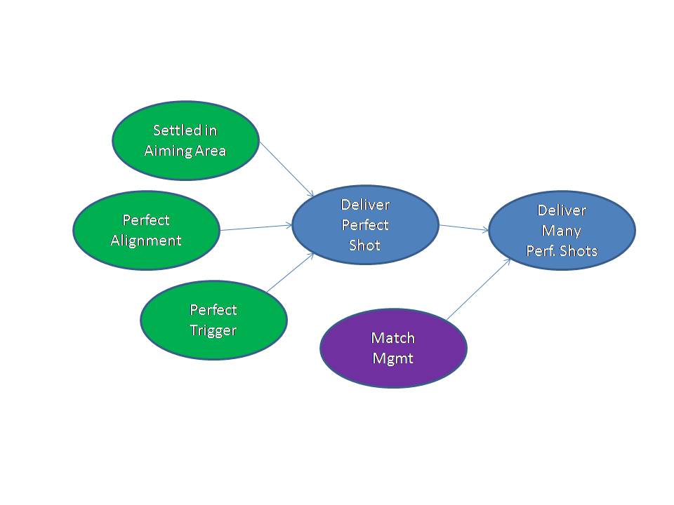

Well it's been a couple of days . . . I guess I can assume that nobody really has any quibbles with the USAMU technique elements?
The next big question is to consider the elements holistically how do they relate to each other?
I suggest developing a "causal map" of how the elements relate to delivery of the perfect shot.
reading left to right
Good Settle in Aiming Area -->
Deliver
Perfect Alignment ------------> Perfect
Shot
Perfect Trigger Control ------>
Going one level backwards then, each of the subordinate sub-elements within each element then causes the resulting element.
The key is that the "prerequisite elements" must be both NECESSARY and SUFFICIENT conditions for hte result to occur. In other words, if we wokr on improving the sub-elements for trigger control, then trigger control will improve. If we work on settling, aligning, and perfecdting the trigger, then our ability to deliver the perfect shot will follow.
Yes? No? Who Cares?

Post by Steve Swartz »
Oh hell
ASCII formatting apparently doesn't work
Hopefully attachment came through
Steve Swartz wrote:If we work on settling, aligning, and perfecdting the trigger, then our ability to deliver the perfect shot will follow.
Yes, up to a point. That's fine for a few shots but I am not sure how complete it is after, for example, having shot 20 perfect (scoring) shots.
BTW, regarding your next post, what attachment? ;-)
Oh bollocks
O.K. you "power users" out there have a good chuckle
With (I think) David's addition
See (I hope?) attachment this time
(doesn't allow .pptx extensions!)
shooting process
shooting process
Shooting Process.jpg (34.39 KiB) Viewed 6741 times
Pat McCoy
Posts: 806
Post by Pat McCoy »
While the method described may be your way of shooting a ten, and may be very repeatable (and easily understood by most shooters), I doubt if the stages are either necessary of sufficient.
Give a group of kids the airguns and basic instruction on aligning the sights and not moving them while the trigger is operated and you will find several differing ways to shoot a ten. Not all will be repeatable, but this shows the steps are not NECESSARY.
As far as SUFFICIENT, I think we've all had perfect alignment but it did not result in a ten becasue we could not get the shot to go off (the dreaded chicken finger).
I am primarily a rifle coach, and see lots of variation in positions among top shooters, who all have extremely high results. I suspect the same is true in pistol shooting - lots of different ways to acomplishe the same result. Sometimes I think we let our own learning technique preferences override our decision in how someone else should be learning (and doing). For example most shooters keep a written diary, but I have one shooter who uses drawings instead of words in the diary. This is a very "right brained" individual and it works for him.
We aren't all square pegs to be put in square holes.
Fred Mannis
Posts: 1298
Location: Delaware
Post by Fred Mannis »
Steve Swartz wrote: The next big question is to consider the elements holistically how do they relate to each other?
The diagram does not portray their interaction, at least not as I experience it. For example, my sight alignment and trigger control against a blank card are pretty good. I can keep the front sight sharp and see nothing move when the trigger 'clicks' for many repetitions. Add a bull, however, and alignment and trigger control are now 'connected' with the introduction of the settling process. Or am I simply not understanding the chart?

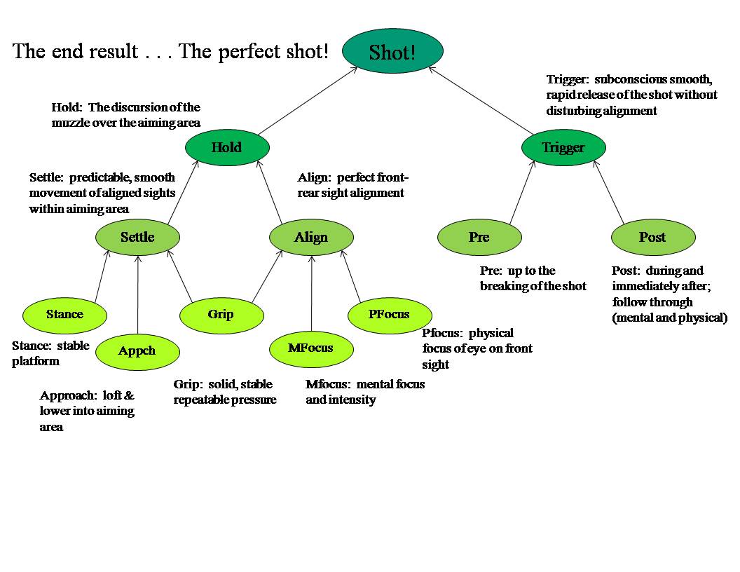

Steve Swartz
Posts: 444
Joined: Thu May 22, 2008 8:06 am
Location: Auburn, AL
Here's the original again that kicked this all off.
I was attempting to socratically build the diagram for those playing at home.
My end game is to improve the fidelity of the model, include detailed descriptions, and provide drills for each element and subelement. I already have all this of course, but my intent is to put it out logically for critique and improvement.
In order to build an "independent study" course in "optimizing yoiur training efforts."

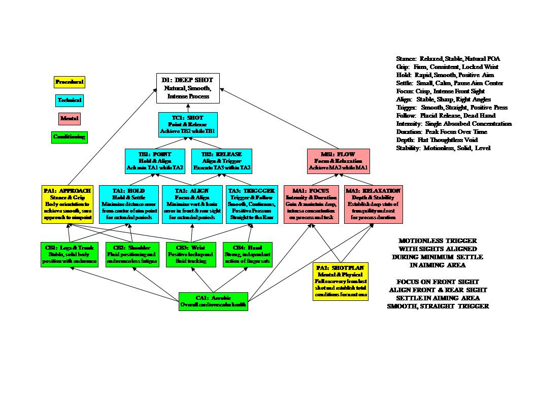

Steve Swartz
Posts: 444
And the third evolution
(Who was it who showed me how to post attachments?!? Yee-Haw!)
Oh sorry but about that align vs aim thing-
If you release the shot when you have "perfect sight picture" the muzzle isn't going to be there anymore by the time the skirt clears.
The shot has to be released *before* perfect sight picture, and while the muzzle is swinging into perfect position.
