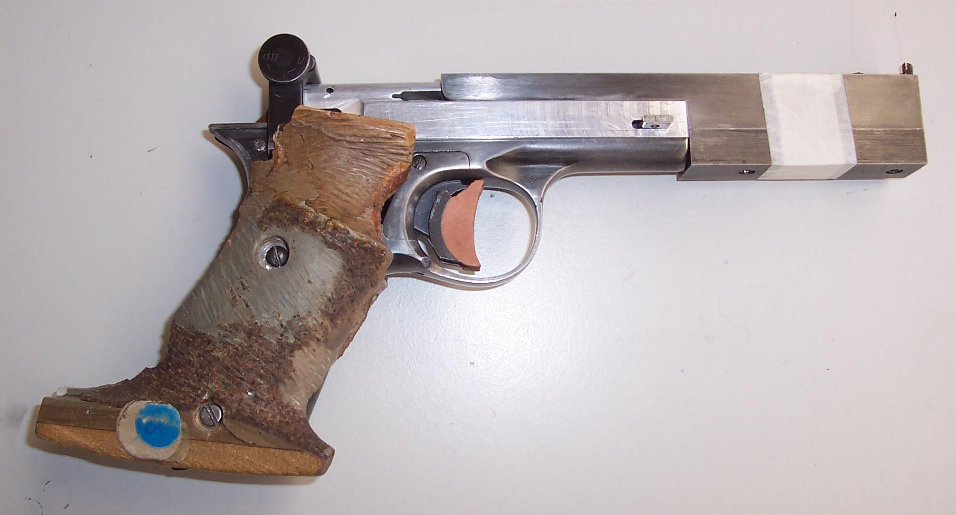

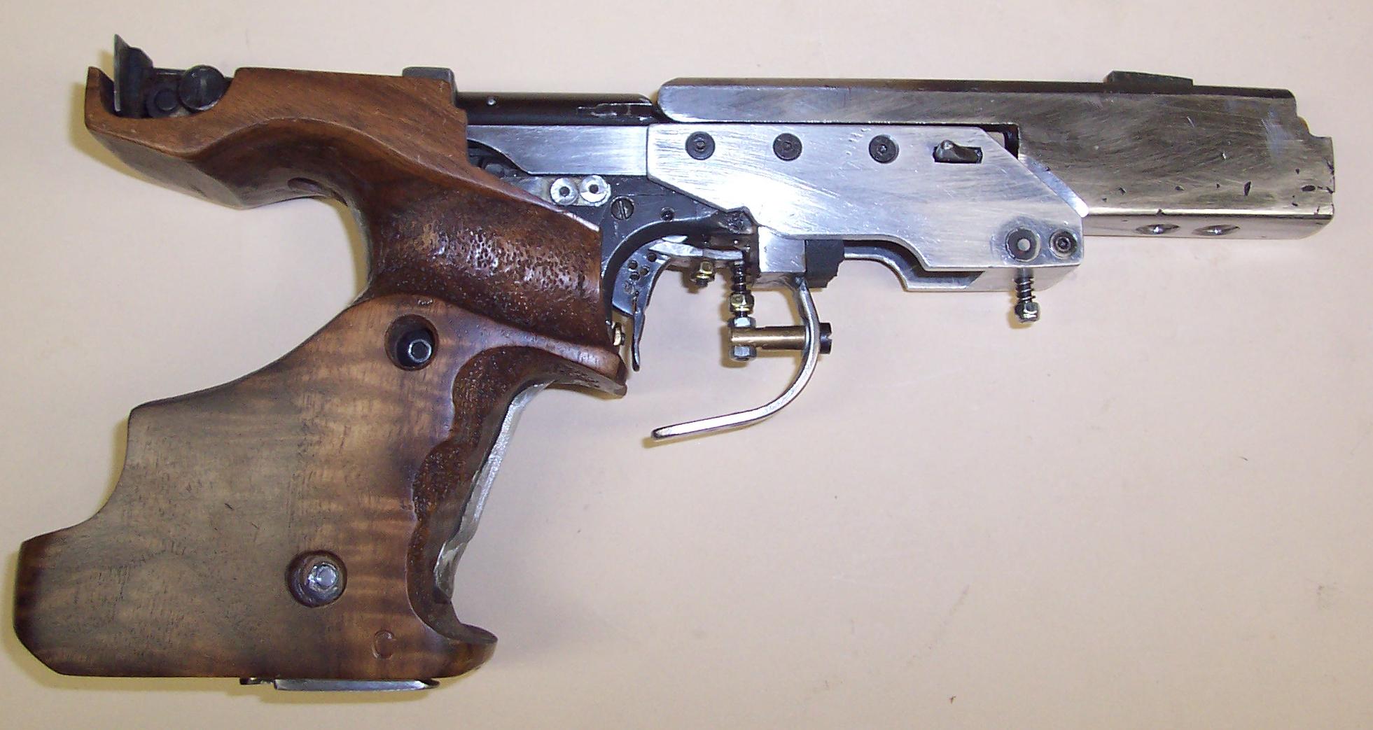

Most MCM's have the slide shortened, the frame behind the hammer cut off, the hammer lightened by cutting off the knurled part and reshaping it not to pinch the web of the hand, a nice barrel weight put on the front, the trigger guard reshaped to a larger round shape, and the trigger bar relinked. If you are really handy you can move the hammer and sear mechanism foward a few centimetres as did Joseph Zapedski of Poland at a past Olympics for a rapid fire MCM. As rough as they are the possibilities are endless on MCM's, and the modifications in Oz are many and varied.

By moving the sear and hammer further foward on the MCM short you can achieve a legally higher hand position that was favoured by rapid fire shooters, in Oz they also use neoprene "green rings" otherwise known as castrating rings used by farmers to castrate sheep as buffers to dampen recoil in MCM's, you place them at the end of the recoil spring they fit very well over the rod and spring, they are hard wearing and dampen recoil very well. There were a couple of gunsmiths in Oz that carried out these mods, as well as enthusiastic amateurs with access to lathes and drill presses. At one stage there was talk of converting a MCM long into a 32 S&W long, but it never got off the ground, the MCM is a very versatile pistol. Will endeavour to get a photo up once I source one.

Thank you for your replies, the mental image I had of a modified MCM was not like the pistols you posted. I guess anything is possible. Can either one comment on how well those pistols shot? Spencer, are they yours?

Neither of these are mine - I associate with some inveterate tinkerers. Both my family's Margolins are standard other than polished innards, barrel weights and grips.

Having a look at the close up picture of the #2 Margolin... I cannot but wonder how much time the shooter has invested in that gun. Seems like a whole of work...

The second of the MCM's in Spencers reply appears to have a rather exotic recoil dampner in so much as the slide comes back and hits a rubber block in front of the trigger guard, this probably makes the recoil very neutral because it is so low down. In Oz some dealers sold MCM's with optional barrel weights they had made up, most people just made thiers up on lathes or drill presses. The trigger can be made crisp or two stage or simply roll-off as preferred by some rapid fire shooters by re-linking the trigger bar in the trigger piece, if you drill a hole higher in the trigger and link it, it makes the trigger crisp, lower down gives a longer pull, to make the sear adjustable you drill and tap a hole in from the back-strap in line with where the sear is located, the screw then allows you adjust the movement of the sear. Some tinkerers in Oz also put a small spring in there to make it even more adjustable.
