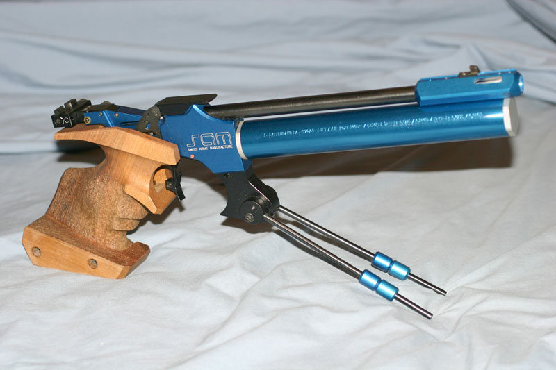

I have factory supplied Morini grips on my Steyr LP-1, SAM K-11 and Morini 162e. Of these I find the ones on the K-11 to feel the best. There is a difference in the area cut out for the palm that works well for me. My buddy with a Steyr LP-10 liked the grips on my LP-1 better so he bought a set from our host Scott. He had done some carving a and filling on his LP-10 grips which he then handed off to me. I have done some additional fitting and shaping and now have them working quite well for me. As a collector as well as a shooter I tend not to alter the grips on my match pistols. This gift grip has saved me the hard decision of mucking around with the original grips. As the LP-1 is my main shooter it has been a blessing.
