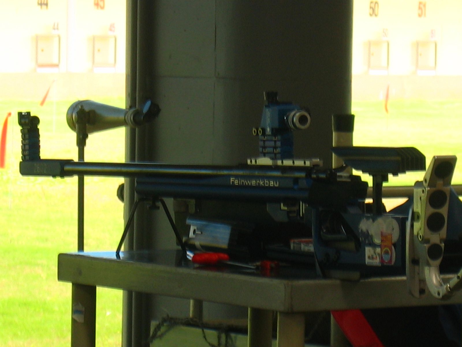

Anyone watched Rajmond Devevec shooting his Smallbore Feinwerkbau?!

Thats some elevation, if you look at recent pictures of Maik Eckhard shooting his Walther air rifle, he has elevated his sights to the maximum allowed. Mind you, Maik like Rajmond has a long neck.
Its worth remembering that the higher you go the more chances of error especially if you use cant.
