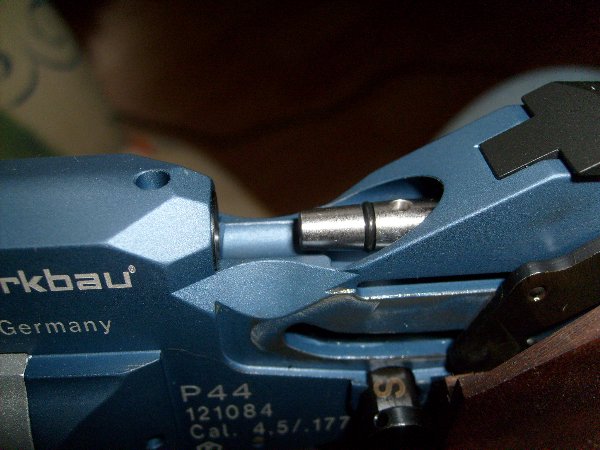

cocking lever damaging the blue finish
Post by Ken »
I've read in another review that when moving the cocking lever it can scrape of the blue finish of the frame. Is that correct?

Ken wrote:I've read in another review that when moving the cocking lever it can scrape of the blue finish of the frame. Is that correct?
I have several thousand pellets through my P44 and there is absolutely no sign of any rubbing or scraping of the finish.
Craig and Kent have commented on the looseness of the pellet seating lever; this is not the case with my pistol. The action of the lever is light, but not loose or sloppy. Definitely will not move without the application of finger pressure.

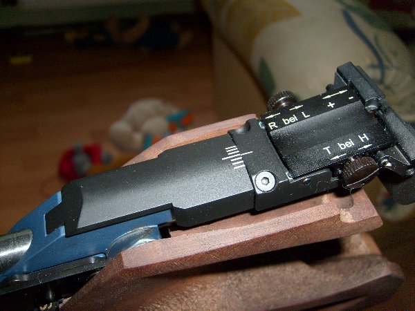

Here there is a german review, with some pictures:
http://www.co2air.de/wbb2/thread.php?threadid=38268
There are two pictures with big scratches on the surface of the frame, all along the lever's run.
Also the review talks about a defect, but i didn't understand clearly what is it.
Best regards,
LukeP.
Luke,
The pictures show what I would call the internal working surfaces of the pistol - much like the wear of the slide rails on the frame of a 22 pistol. They are not 'scrapings' or 'scratches' due to improper fit of the parts. In fact these surfaces are lubricated with a light film of grease. When the cocking lever is down they are hidden by the lever. If you want a pristine pistol, hang it on the wall and don't shoot it.

This kind of wear doesn't appear on an LP10 neither, even after years of use and thousands of shots.
I have seen used previous Feinwerkbau pistol models (P34 for instance) and I must say that the surface finish seems prone to wear and scratches (the black frame become white at the edges, the compressed air cylinder looses his red color finish, this finish doesn't seem to be anodized aluminium like on most other brands, but painted) what doesn't happen with other brands.
What the German guy is saying is that the two blades of the rear sight (that can be adjusted for width) are not well aligned/symetric. I do not know how the rear sight is made on the P44 but on the LP10, before changing the width you have to untight the two screws that hold the blade used to adjust the depth of the rear sigth. If you do not do that when you try to reduce the width, there is also a risk of misalignment of the two pieces of the rear sight.
After having tried a second P44 having the same problem, he finally exchanged his P44 for an LP10 !

Those "scratches" also appear on my P44. Whilst the long term durability of the pistol has yet to be proven, I can't say I'm overly concerned.

What is the finish of the pistol frame (the blue part) and of the compressed air cylinder ? It looks like it was painted and not anodised what could explain the softness of the surface and the fast wear.

I'm no expert but it looks like paint to me, and that would certainly be consistant with FWB manufacturing process, as per previous products.
I have noticed no deterioration of the silver finish on the cylinders as yet.

The scratches that you talk about where not present on my gun, there was a clearance of at least one mm. But, the loading lever would close if one leaned the pistol forward just a tiny bit. The rear sight does not have an adjustment for the depth so it is not as the LP10. The rear sight was to be corrected by grinding, it was like 14 passed 9 and if you once SEEN it, you MUST do something about it. Very disturbing. I have had this on some Morini too so it is not an uncommon problem, but as long as you do not see it….
