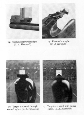

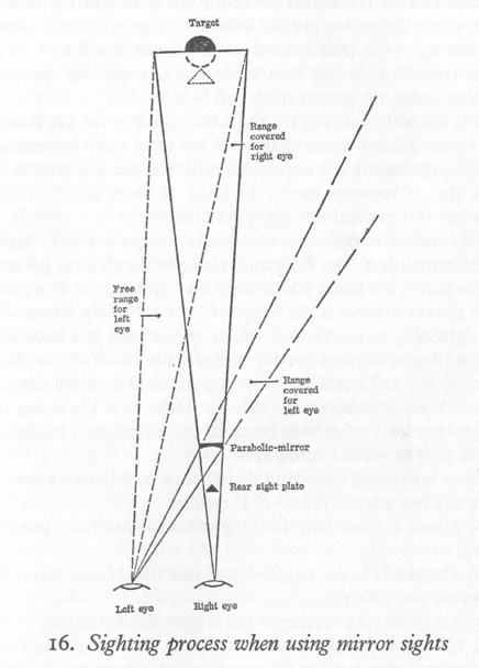

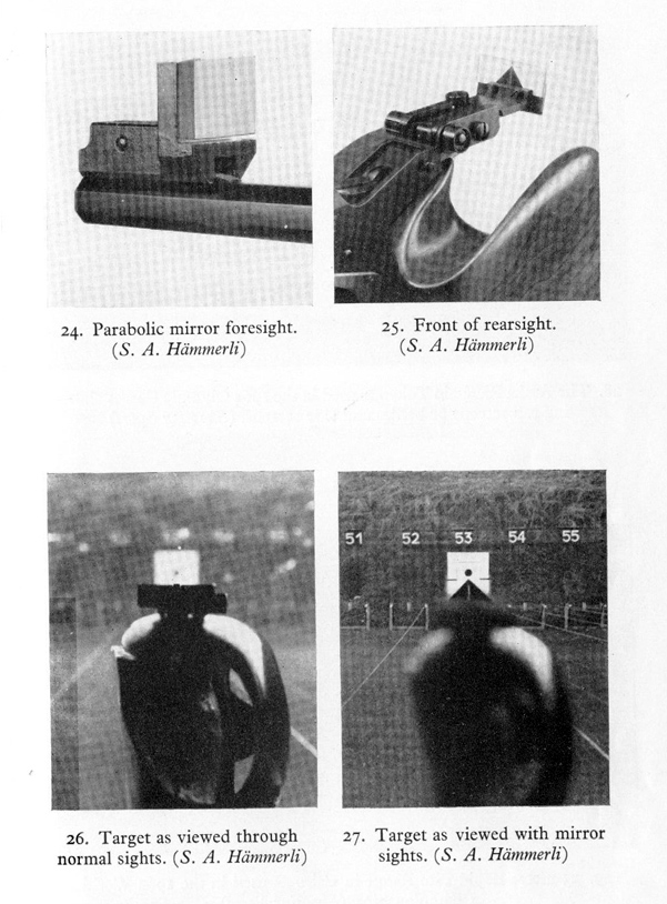

Here it is quoted directly from P.C. Freeman, Modern Pistol Shooting, Faber and Faber, London, 1968, pp 104-106.
“The mirror sight has been introduced to free pistol shooting by Reiny Ruess, a member of the Swiss National Team. It is described in the March 1967 edition of Hammerli News and the following description is adapted from this bulletin. The foresight is substituted by a parabolic mirror with a focal length of the distance between the mirror and the backsight. The conventional backsight is substituted by a small plate which is white on the target side with a black triangle whose apex is just below the centre of the plate. This triangle is reflected in the mirror and because the mirror is parabolic the focus to the eye of the reflected triangle is at infinity. The target is also at infinity to the eye. The eye can then focus on the target and the reflected sight at the same time. The backsight plate must be well illuminated and this sight is not suitable for indoor ranges.
The method of aiming is to bring the pistol into the aiming position and let the mirror cover the lower half of the aiming mark. Close the aiming eye and focus the other eye on the target. The aiming eye is then opened and the triangle will be seen in the mirror. The shooter then brings the triangle into the right position under the aiming mark and fires.
This method of aiming has the advantage that the eye is used in its most relaxed focus. Both eyes are open and conventional shooting glasses are not required. As the shooter grows older he finds that it becomes harder to focus at short distances and therefore this method will appeal to him.
This method of sights has been approved by the U.I.T Technical Commission.”
Which is not terribly clear – but it seems to indicate (as the attached pictures show) that the pistol is aimed with both eyes open and both the foresight (or its equivilent) and the target would be in sharp focus. If my interpretation of the diagram is correct, it would also appear to effectively double the sight radius (which may not actually be a good thing). It certainly would have been a paradigm shift away from the mantra – “foresight in focus, target blurry”.
It seems like it was an interesting idea that never really took off.

You're right about the doubled sight radius. We have one of Reiny Ruess' originals in our collection - and while it's an interesting idea, I think it's terrible to shoot. But the principle works, there is only one thing to look at (beside the target).
I know someone who tried one of these mirror sights for a few months but gave up. It seems that it was very difficult to use in changing light conditions.
Incidentally, in case anybody wants to shoot one in competition, it is banned under ISSF rule 8.4.2.3
