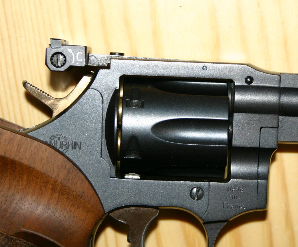

I put a Morini rear sight on my Manurhin. That still needs a screwdriver, but gives me a perfect sight picture and adjustability.

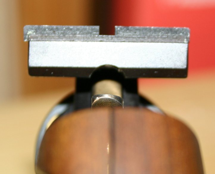

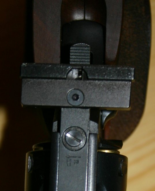

OK, let's see how good these pictures are. I'm not the world's best photographer, obviously...
We used a Manurhin spare part for the mount, so I still have the original. Mechanically it wasn't a problem, we just had to check it twice to comply with the 220mm rule. Haven't seen it done elsewhere, though.
Work was done by Viktor Odermatt, one of the top ISSF pistol gunsmiths here in Switzerland. Used to work with Cesare Morini, and is an absolute magician on the FAS 607.
Please notice the cutout for the hammer. Didn't hurt the sight, though.
Well I'm not complaining - as they say a picture tells a thousand words!
I'm going to see a gunsmith on the weekend and show him what you have done - exactly what I want. Switzerland is a bit far from Australia. But now I have an example of what I want it should be easier.
OK I still have to carry a screwdriver but I never really expected not to...!
