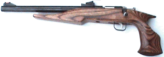

- Posts: 16
- Joined: Tue Jan 31, 2006 12:16 pm
- Location: North Carolina
Rogue Rifle Company
Rogue rifle company makes this single shot left bolt pistol, the trigger would not be any good but might be a place to start, i have been thinking about getting one to play with, only a couple of hundred bucks.
- pistol-40004-41004-42004-43004.gif (32.17 KiB) Viewed 3540 times
I think this action must be manually cocked after closing the bolt, not a problem with the grip as pictured, but it would be hard to make a "free pistol" grip with this cocking feature? Sounds like the price is right, and if you wanted a basic grip, this might be a good starting point. Now for the trigger. Are we trying for a 8-16 ounce trigger? Maybe find a way to move the rearsight rearward and chop off some of the barrel.
