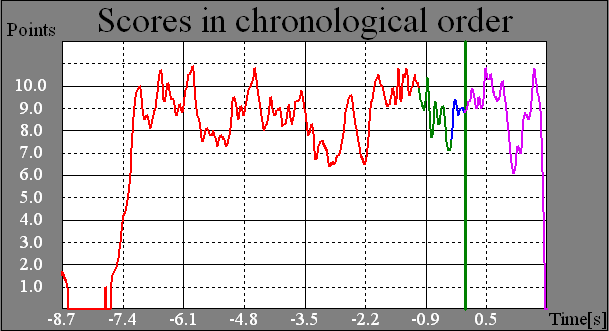

Last nights Rika session was an eye opener for me. 6/10 shots inside 9.5, those 6 holds inside the 9 ring. But then it goes to pot - a 6 or a 7 and some wideish 8's. Some I could not account for, but the wild ones (6's and 7's) were due to a 'bouncing' hold. Looking at my trace I see that in many cases, every 3 seconds or so (almost regular as clockwork) I have a sudden big movement in my hold. I don't think it is a twitch as such (or is it?) but those wild shots are a trigger release when the 'bounce' occurs.
Since the 'bounce' doesn't happen every time can I rule out physiology? ie is it more likely a lack of conentration/control over the shot?

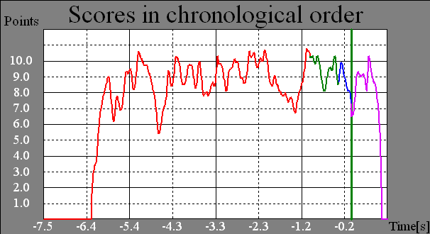

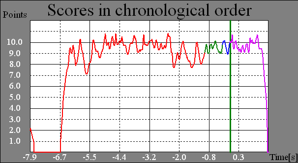

I only dry fire with the Rika..... I'm not sure I would call it a twitch. It's not that instantaneous (ie the movement and recovery takes about 0.5 to 0.75 seconds.) and sometimes I 'bounce' on the recovery. If you look at the time series plots you can see what I mean. (These were all shot in the same string of 10 shots).
Each plot represents one shot and records where the pistol was pointed in time series (green vertical line represents the triggering)

Looks like you have an admirably stable hold in the 2-4 second zone . . . that begins to decay quickly as you approach 6 seconds . . .
Are these three charts truly representative of your holding performance?

Yes. I'd like them all to be like b10, my average is like b8 and my 'off shots' are like b6.
