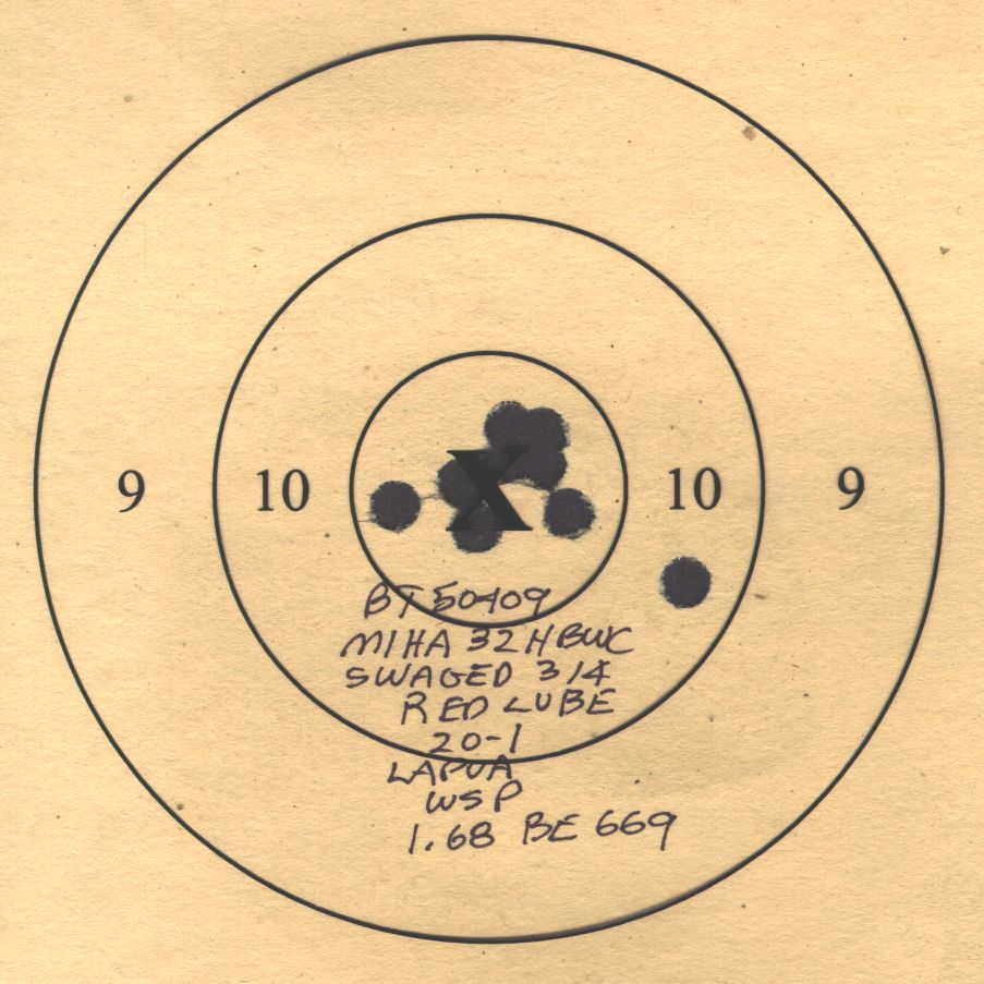

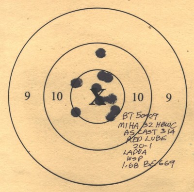

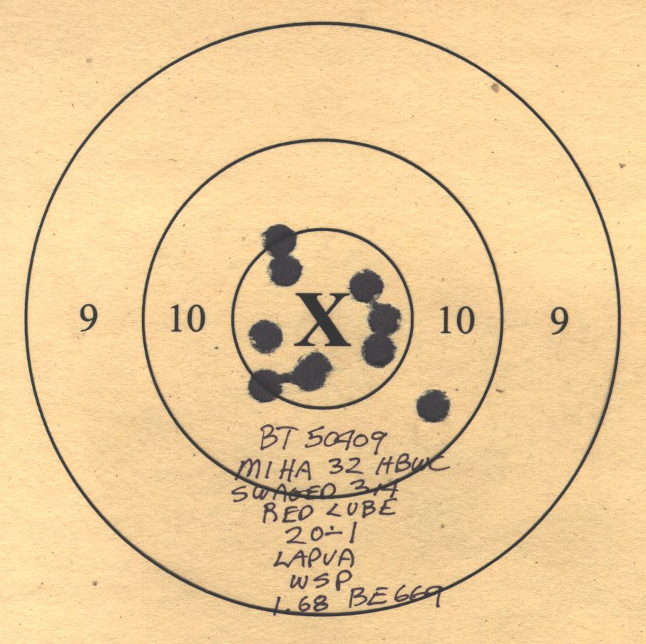

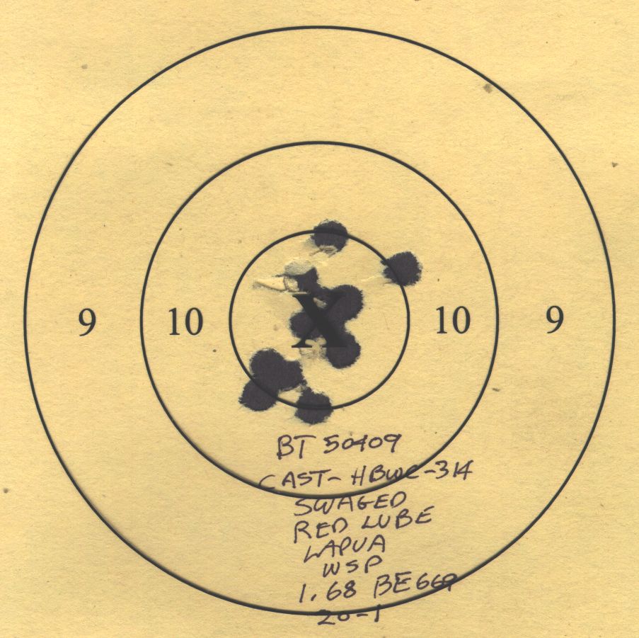

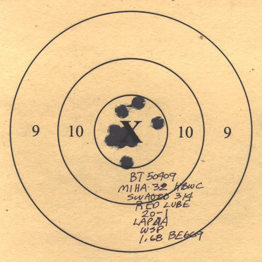

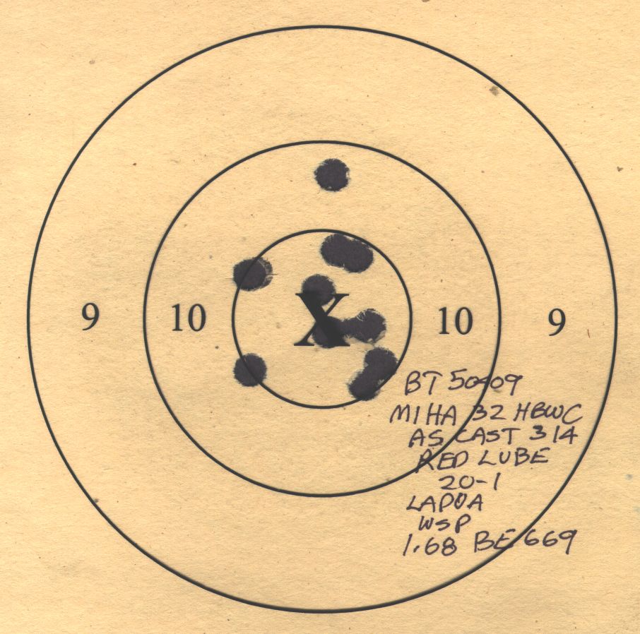

I had one of the MIHA HBWC moulds in 32.
I used 20:1 Lead:Tin alloy.
Very labor intensive. I ended up selling the mould and went back to swaged bullets.
Attached are my test results at 50 yards. It was A Haemmerli SP-20 barrel mounted in a machine fixture.

fc60... would you mind elaborating on the SP20 barrel mounted in a machine fixture. I am curious how you made it happen.
