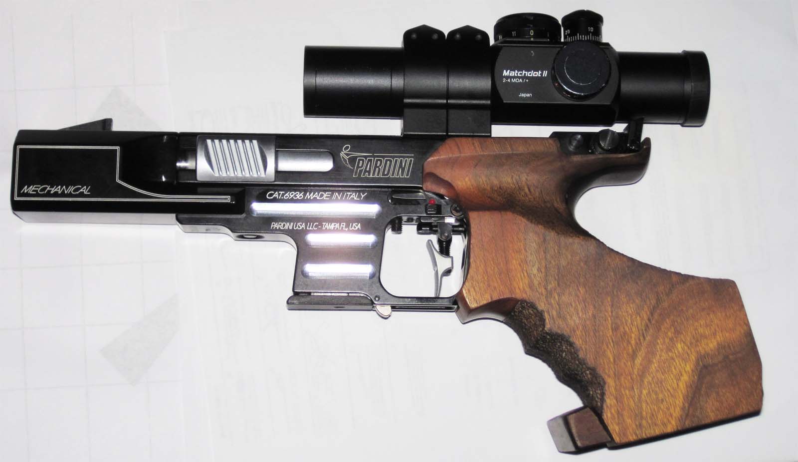

Most olympians pistol shooters use the Pardini but it is by no means necessary to do well in Bullseye. I believe the current NRA Bullseye record established by Jim Henderson was shot with a Hammerli Xesse set up by Larry's guns. I currently shoot (and love) the Pardini SPBE in 22 and 32; prior to this pistol, I shot a well worn Walther GSP and before that, a S&W 41 7.375-in barrel that I bought in 1972. I've also shot HS Victors and Sharpshooters; both shoot very well. Years ago I used the 41 for squirrel hunting and made many head shots, from a rested hold, between 30 and 50 yards, especially when shooting from up in the trees. I thought of it as my small rifle.
Glory days begone. But I am loving retirement with my Pardini; accurate pistols are fun to shoot and it is very accurate and very reliable; it eats almost anything you put in it (I recently bought some Fiocchi SV in which the bullets were a little longer than usual and did not fit in magazines well). CCI SV shoots very well and is more accurate than I am precise, but every now and then I seem to need to spend more than necessary on more expensive ammo. I've had one stovepipe with a 22 out of thousands of rounds. Pardini imports the parts into the U.S., and the guns are assembled here (which somehow gets around certain import restrictions). I have never had any problems with mine (well, except mental ones). I confess that for some reason I left the safety on after load testing and at my next regular BE match, I couldn't get my beloved SP to fire. I was completely stumped. I had to borrow a pistol to shoot an 1800 match backwards (shooting the 45 while others were shooting rimfire and the reverse). Only later and much to my chagrin, after worrying all-the-way-home, did I discover I had left the damn safety on! Not my most brilliant moment: pistol safety device (a safety) stumps old pistol shooter...
Scope
I use the MatchDot II 30mm scope; it enables me to use one scope for two calibers and it works repeatably and well. Its biggest advantage is you can "zero" the elevation setting by unscrewing the elevation turret, pulling it up, and setting it on "0" after you have your pistol dialed in. So, I zeroed it for 22lr at 25 yds, adjust elevation setting +3 clicks for 50 yds., and for 32 ACP, my setting is +6 clicks for 25 yds and +10 for 50yds. I've never had to move the windage more than one or two clicks off "0" and that works for both calibers.
Rings
I have tried a bunch of rings: the ones included with the 22/32 package from Pardini would not hold position with the 32 ACP (this experience varied among shooters). Pardini kindly sent me another ring to back up the front ring, but three rings still failed to hold the scope in position with the anemic recoil impulse of the 32 ACP. I think the rather wimpy cross-bolt screws that clamped the rings onto the groove at the top of the frame were the fault. I then went to Warne rings for the 19mm dovetail (made for CZ rifles). These are steel rings and hold like glue (no Loctite needed). However, you have to ask Warne to send the front rings only (tell them you are using the rings for the Pardini pistol). However, I abandoned these as they were about 0.75-in higher than the low rings that Pardini initially sold with the pistol. I prefer the low rings.
I now use Warne 30mm low mount rings. These keep the scope low on the pistol and I've mounted both rings on front of the scope, which leaves most of the scope hanging over grip, and moves the center of gravity to the rear (see image). These rings are made for pickaninny rails. They will mount better if you file the inside angle of the ring's feet (both sides) to make them fit in the frame groove. They hold like glue and if you use the same mounting point, they return to zero or nearly so, which enables you remove the scope and shoot EIC or international matches, and remount the scope for centerfire stage. Regarding mounting rings: make sure the scope is correctly leveled with respect to windage, e.g., use a level set on the battery lid, while holding the pistol (without magazine) firmly on a level table (setting on the magazine well). If done correctly, you should not have to change the windage setting much from the factory "0."
