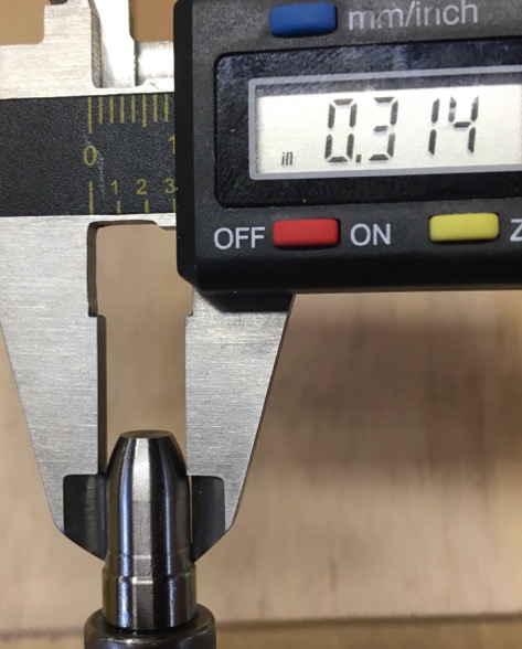

I have an M expander but have not used it yet. I measured the expander and see the first step is .310 and the second step is .314. I will try and submit a picture of the expander insert to illustrate what I'm talking about. I am thinking about taking the insert expander piece (it unscrews) and taking it to a machine shop to have a duplicate made with .002 oversized dimensions. The reason is I think the LSWC bullet might deform/swage a little due to the small size of the bullet and a tight fit for bullet seating. Does that sound right or am not overthinking the sizing/seating issue?

Emmett the part where the expander goes into the brass should all be .314 and the part that is .314 should be .250 long with a small curve on the front so it won't catch the brass and a place on the back to flare the brass so the entire machined area is longer than the .250. If you want to flare in a different step, then the .314 area can be as long as you want and you can adjust how deep it goes into the brass by raising or lowering the die and then use a different tool to flare the brass.

Thanks for info. I guess I didn't fully understand the earlier discussions. So when I go to the machine shop I want to tell them that what I want is to make the total shaft .314 and the second step area that is currently .314 make sure it is flared in order to not catch on the case lip. What size should the diameter be? I want that step to be .250 in length, and the width .316?, .317? Or do I just want the flare to start at the point where the second step begins? The length of the initial expander die (first step) looks like good. I will tell them to keep that length the same.

The tip that is curved so it won't catch on the edge of a case can be any length and should be typical of what is on any expander similar to your picture. After the curve, it should be .314 for .250 inches at which point it should get larger so the case will flare. The flare part is very short. If you want, the part that is .314 can be longer than .250 so you can experiment with how deep you expand your case and then use a different die to flare the tip. The M die you already have will flare the case. If the .314 part of an expander is shoved in very much past .250 inch mark, it will probably bulge the case too much. The base of the bullet is right at .250 and generally when they are loaded, about .010 to .020 is in front of the case so expanding the case below the .250 distance is most likely a waste of time.
