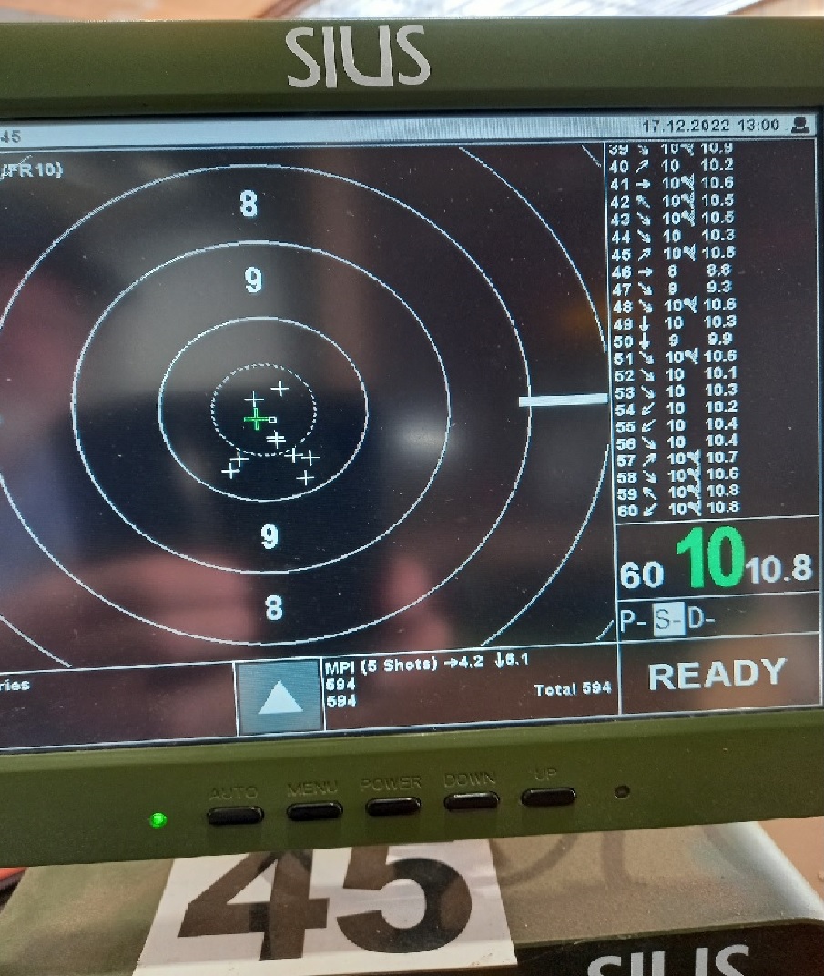

Gwhite wrote: Mon Feb 05, 2024 8:25 pm You are still obsessed with scores. Unless you spend more time working on improving your shot process and less time adding up meaningless numbers, your progress will be slow & painful.
I can shoot a 540 by firing nothing but sixty nines. I can also do it by shooting 54 tens and 6 complete misses. I can do it by shooting 30 eights and 30 tens. None of which is important. What IS important is why each shot arrived where it did. You need to work on eliminating the poor shots and increasing the number of good ones. You should be concentrating on improving your technique & consistency, NOT your scores. Good scores will be easy IF you fix your technique.
The minimum in
This target was an eigth…
Can you teatch me do always this?
10 meter Shooter

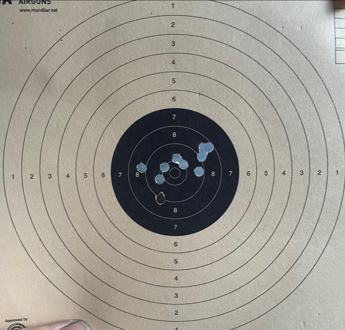

Gwhite wrote: Mon Feb 05, 2024 8:19 am Actually, if he's right handed, he's probably applying pressure with his thumb. All your life, you've practiced squeezing things between your thumb & forefinger. If you let your thumb get in the act when you squeeze the trigger, your targets will look just like that.
You do NOT need thumb pressure on the side of the grip to hold the pistol. Shooting a good group is all about consistency. The most consistent pressure you can apply with your thumb is ZERO. Get it off the grip, and those shots should evaporate.
If he's a lefty, it would be finger tip pressure.
Target 0-60 shots
The out between 3/4 on the bottom It's because the pellet was upside down with the skirt forward and the the two others on bottim 4 and 5 was because i move the arm at the time of the shot!
Thank you
10 meter Shooter
Posts: 3573
Re: My Feinwerkbau P44+R10 Match+R10Match Plus
The horizontal spread is probably the result of grip variations, possibly thumb & finger tip pressure. The shots out in the white are most likely anticipation, which can come from forcing the shots off. You need to concentrate on increasing the pressure on the trigger smoothly. As long as you do that, the shot WILL go off, but you won't know exactly when. You don't have to do it super slow. Practice dry firing and work on seeing how quickly you can squeeze the trigger without disturbing your sight alignment. Most shooters take WAY too long to get their shots off.
https://www.targettalk.org/viewtopic.ph ... 11#p314411
In my experience, a backwards pellet usually shoots just fine in most pistols, but the hole in the paper does look suspicious.
It actually looks like the center of your pattern is low, and a sight adjustment is needed. The scattered shots above that may be from losing focus on your front sight. It's important to "call" every shot. If you didn't call your shots accurately, you are probably not concentrating on sight alignment and your focus is wandering.
When you get a good shot, try to think about EVERY detail that went into that result. That will help to make them happen more often, and if something is not right, it will help you identify it BEFORE you take the bad shot.
When you get a bad shot, think about what might have caused it, and what corrective change would have prevented it. Then forget about the shot, and work on your technique. Think in terms of POSITIVE actions, like focusing on your front sight and smoothly increasing your trigger pressure.

Thank you! I just started a new target 0 and have 3 out… because i move my arm 2 and 1 because i put the pistol to high! The sigth is fine for the club but this practice has been done at home and i have to adapt

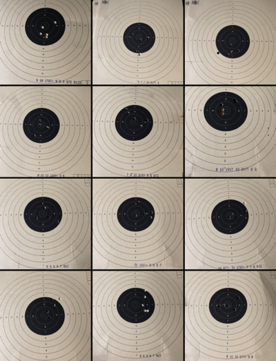

Tonigth in the club i made 511 points! Belliow i send the targets! 5 shots-12 targets
