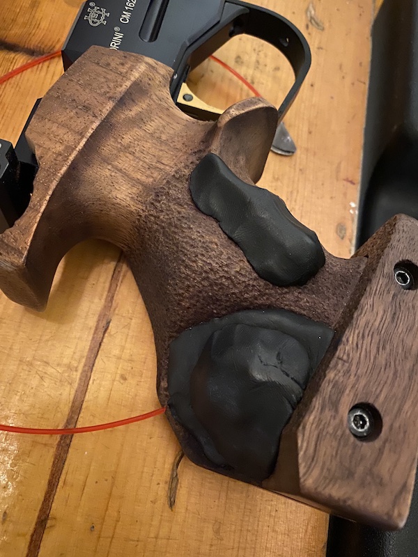

atomicgale
Posts: 865
Re: Get a grip, man!
Post by atomicgale »
It is ART?
. . . or something laying in the backyard you almost stepped in?
. . . not quite done with it yet . . . .

atomicgale
Posts: 865
Voila'! A veritable Michelangelo.
After multiple putty/grind/sand; hopefully this is last iteration prior to final spring CMP match.
