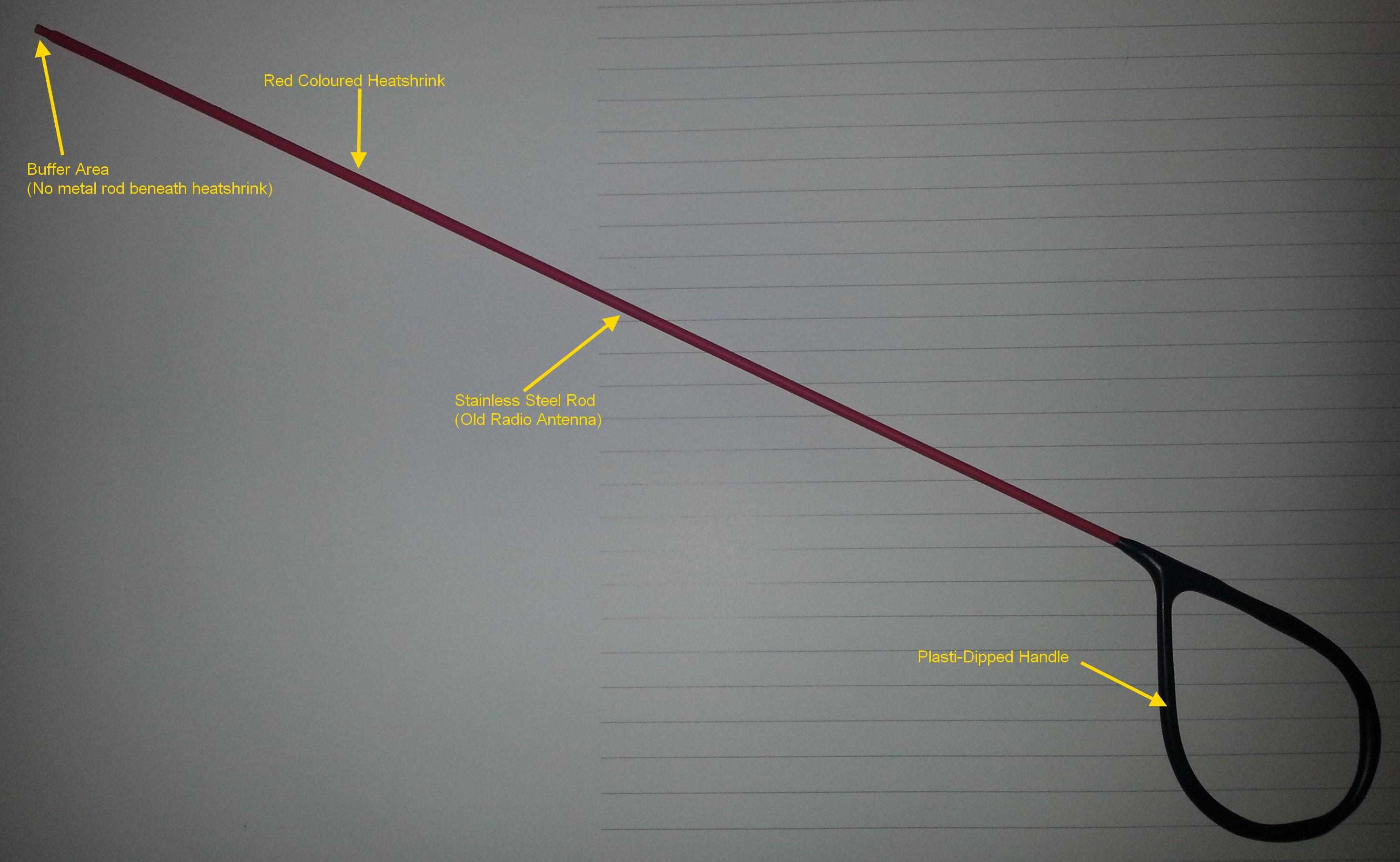

rloebler
Posts: 30
Joined: Fri Jul 06, 2012 8:03 pm
Post by rloebler »
I knocked up a quick Air Pistol flag this morning at work. It's made from a stainless steel two-way radio antenna covered in red heat shrink. Not sure if it will suffice. What do you think ? The buffer area at the front prevents the hard metal rod pushing up against the pellet loading ram. Being solid it passes through compensators with ease.
rloebler wrote:I knocked up a quick Air Pistol flag this morning at work. It's made from a stainless steel two-way radio antenna covered in red heat shrink. Not sure if it will suffice. What do you think ? The buffer area at the front prevents the hard metal rod pushing up against the pellet loading ram. Being solid it passes through compensators with ease.
Under the latest ISSF Interpretations, "Safety flags must be of a bright color that Range Officers can easily see at a distance. Fluorescent orange or a similar bright color is recommended.?
Is it flexible enough so that it can come outside of the gun at both ends (which is the clear intention)?
rloebler
Posts: 30
Post by rloebler »
I read that bit about extending outside the gun about five minutes after I posted the pic. The rod is stiff and thus could not bend to extend outside of the breach area. On that basis it's probably not good enough.
