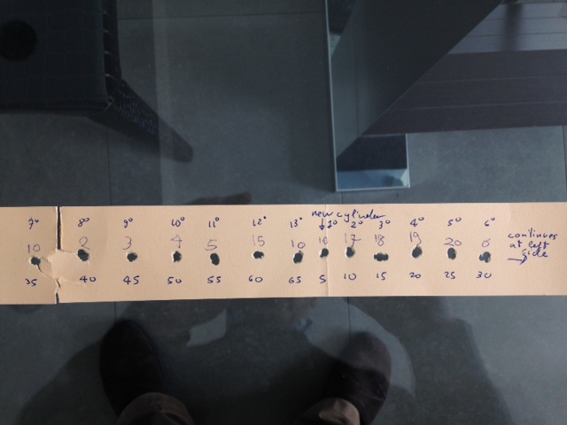

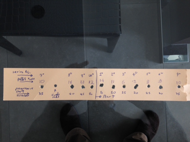

I have had similar problems with my Lp10e. I did an ammunition test 3 weeks ago. I tested about 25 diabolos differening either for production set or for model/ producers. Only one out of. 25 had a nice superposition. This one I tested again five more times. However , consistently, at about 50% pressure, i.e. 100bars, the 5 shots spread to about 7-8mm diameter.
Since then I am now replacing the air cylinder when it reaches 100bars, even if Steyr, after fixing my pistol (for the trigger problem which I experienced) , wrote me back saying that air system was also tested and worked fine and that I could shoot 120 shots with each cylinder.

this is an example of the ammunition test. I bought pellets N.10
therider
Posts: 456
Location: Germany
Post by therider »
just see the difference between series n. 7 (from 30 to 35 shots), then series n.13 (from shot 60 to 65) and then subsequent series n.1 (new cylinder) ( from shot 1 tp 5).
Series 13 is easily 7 mm opening
