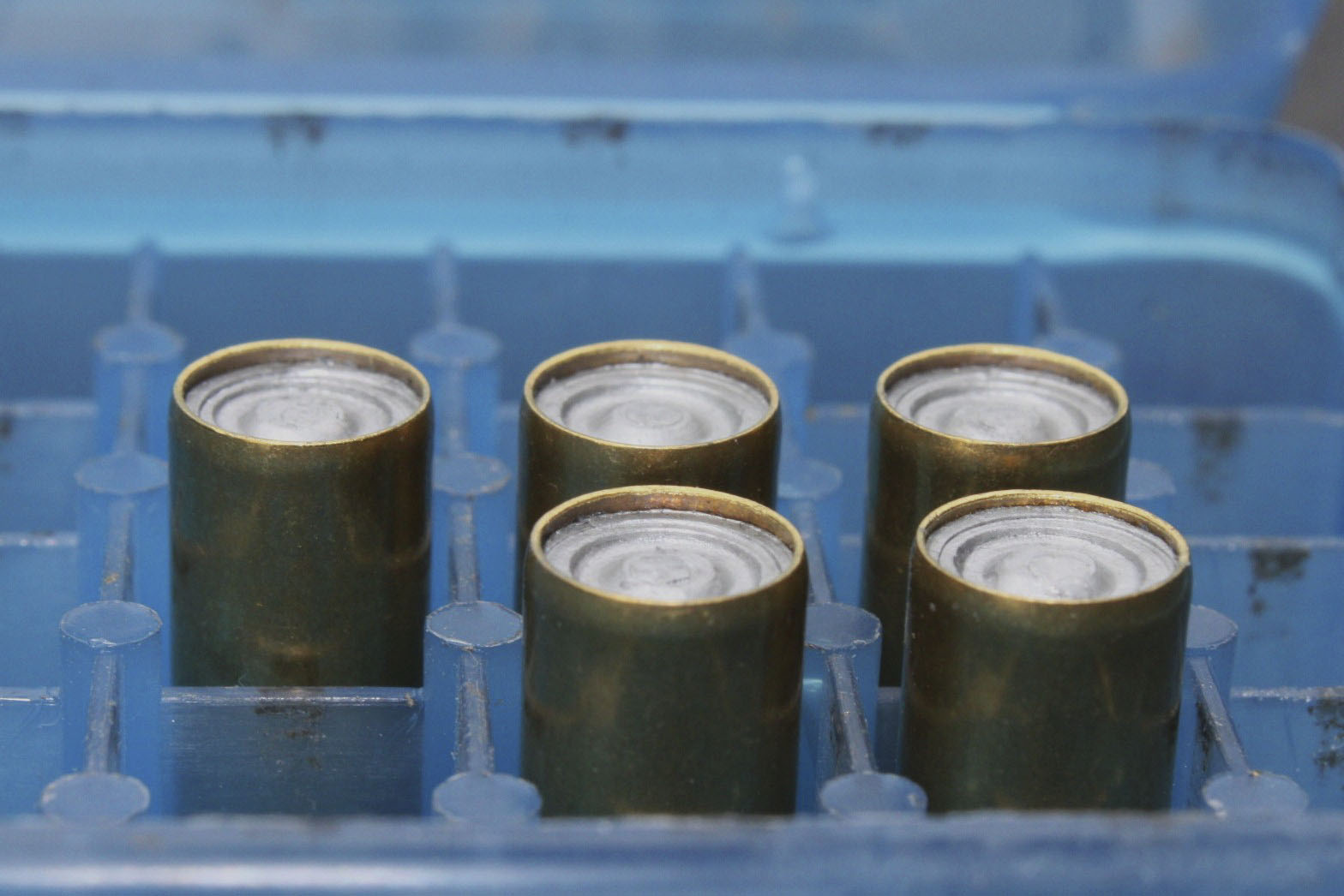

30 fixed cartridges. Projectile sits deeper now. I will try them coming Saturday.
Our club has reload equipment, as I have heard. Members could use it. May be I will try to load myself next time.

Those cartridges look good to me. Good luck and happy shooting! :-)
They actually look a bit too deep to me.
It looks like you have pushed them down so that the centre "pip" is flush with the case edge, which means that the edge of the bullet is below the case edge.
It's the edge of the bullet that should be flush with the case edge as shown in the picture on this Lapua page.
David is right in his statement, but those cartridges should be good enough to check if the cartridge overall length was the culprit of those jams.

You are right about the Lapua bullet seating depth, on the other hand Fiocchi factory seating depths are much deeper, the "pip " is a full 0.71mm or .028 thousandths below the case rim. For what it's worth, I have seated my bullets the same as Fiocchi and never have had a failure to load . But then i have a GSP and they shoot anything that fits the magazine.

Be careful, Fiocchi's bullets don't have the "pip", are a perfect cylinder.
Seating bullets deeper in the case increase the pressure. Now it seems that the cartridges in the picture are less crimped than before.
