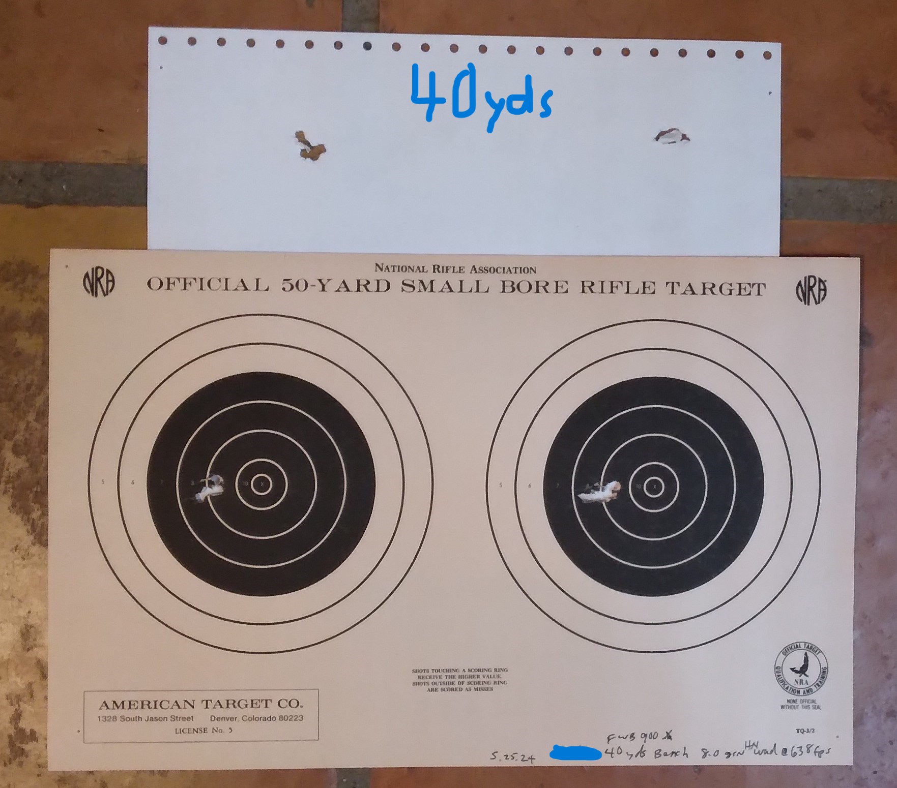

Turned the hammer spring up a bit on the FWB 800x/900, and is bench grouping one hole at 40 yards, need to try more bench at 50 yards with it.
It takes some time to settle down after you turn the spring.
The planned goal is Standing at 40 yard and/or 50 yards with this 10 meter air rifle.
Am getting close to 688 fps with a 7.0 grain wadcutter , 11% increase, 640 fps with a 8.0 grain wadcutter, 9 % increase.
40 yard one hole, 50 yard a bit bigger, but need to try 50 yard again, after it has settled.
I may get more fps, need to play with it more, it is possible that I either went to far or too little.
But only turned it a shy 30 degrees. It is a short thick spring with short travel, fast lock time, a little
turn does a lot.

This is benchrest , IMO, good results for use with Standing.

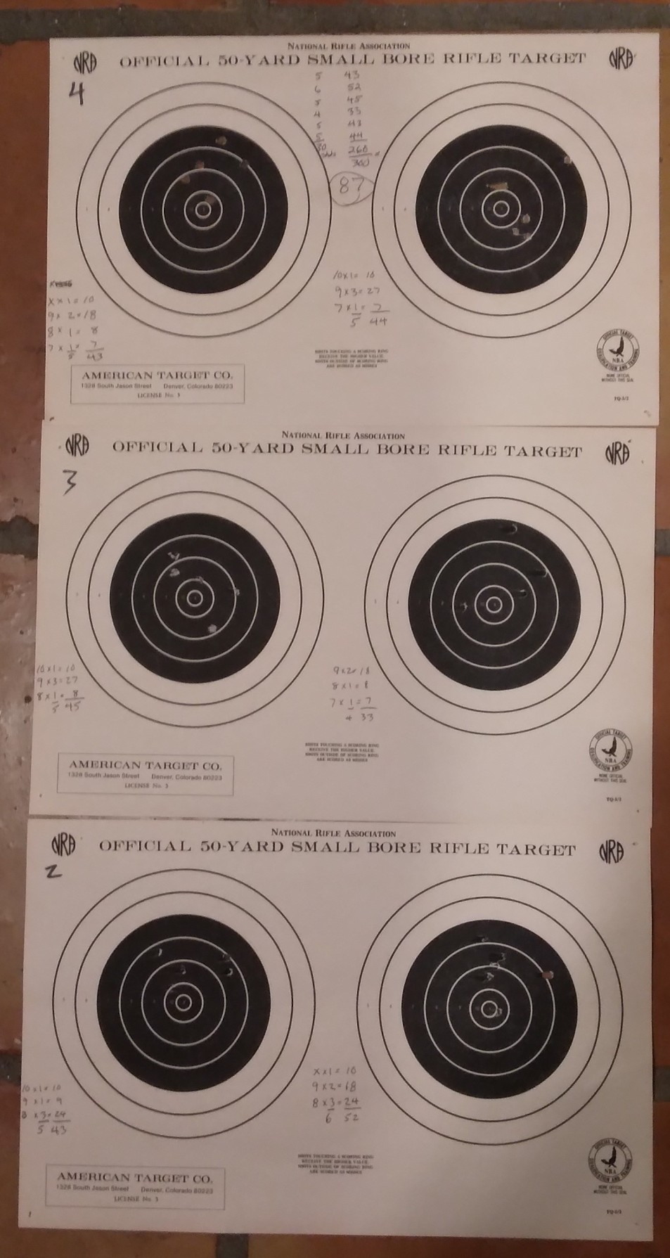

Last night was the first Standing at 40 yds with the FWB 10 meter rifle, 20x scope. It is quite tricky. Got a 260/300=87%
Trying for 50 yards now. What I am seeing is that after the hammer spring is adjusted/moved , it takes about 50 shots for the shots to settle in
and group well.
The fun part is when done correctly, crosshairs on the X, you can see the pellet go thru the X , crosshairs on X before , during, after. Trying for 50 yards now. What I am seeing is that after the hammer spring is adjusted/moved , it takes about 50 shots for the shots to settle in
