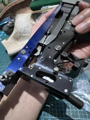

Good news~ @ GWhite. My theory worked. I used a steel screw to stop the outer screw spinning while doing the inner screw. I tried nylon screw first but it’s not strong enough to stop the spin. For the steel screw I was really careful to put the pressure in as you said it may chew up the threads.
Now I’ve perfect 1005g trigger weight.

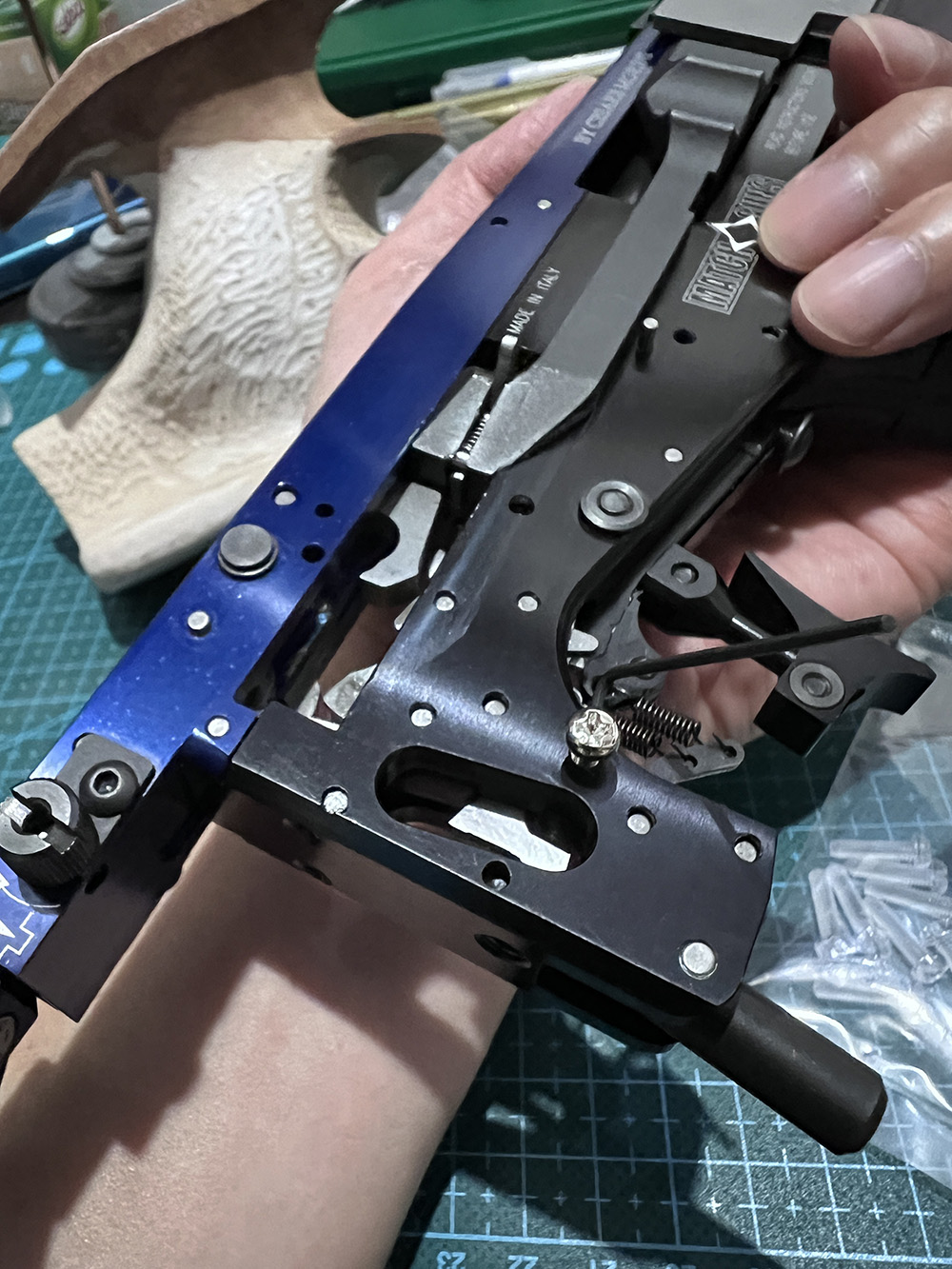

here is a photo showing the screw I used to stop the outer screw spinning.

You want to have something to prevent the trigger screw from shifting from firing vibration & repeated trigger operation. You can mimic what the factory apparently left out of your pistol Shave down the end of a nylon screw so most of the threads are gone. Then cut ~ 1.5-2 mm of that to put in the hole as a soft plug and back it up with a steel set screw.

Snap! You are absolutely expert! I’ve just done that.
I used a nylon screw only but left the end on. So I had to carve a shallow channel on the inside of the grip to give the end of the nylon screw a bit space.
I found the shifting issue a couple of days ago while training. I shot 100 rounds but the trigger became lighter and lighter towards to the end LOL.
