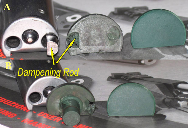

Regarding the recoil dampening rod (and the 13 O-rings) in the Bullseye SP; I got rid of them and rely exclusively on the green dampening buffer. I did this because the recoil dampening rod actually damaged the green buffer (after may be 5K rounds). I spoke to Alex about it and he said that was OK, but cautioned that I should check the green buffer pad regularly to make sure it's undamaged from wear. Attached image shows damage cause by the recoil dampener in the Bullseye SP model. dipnet

I'm confused... It may be the bullseye model, but I didn't think pistols with the buffer rod & O-rings in the bolt used the green buffer. Unfortunately, the newer SP's I work with that have the buffer in the bolt are in lock-down still, and I can't check them.

I think they put together whatever they had for a while.
The green buffer is gone now.
Their quality was real poor the last years. Often they did not last a box of Lapua.
I have glued a 2.5 mm thick piece of softer rubber on them. Works, but what kind of glue is tricky. I will try just a dab of the glue gun next.
