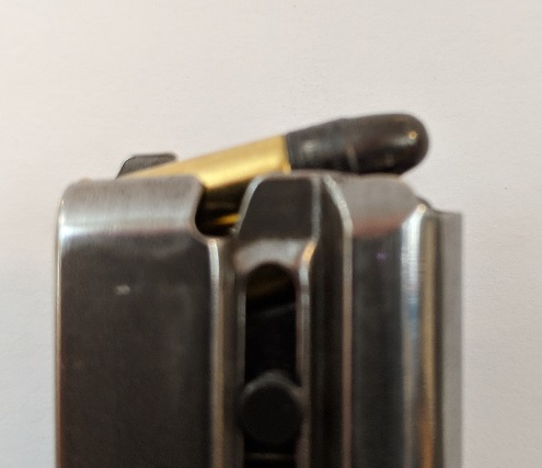

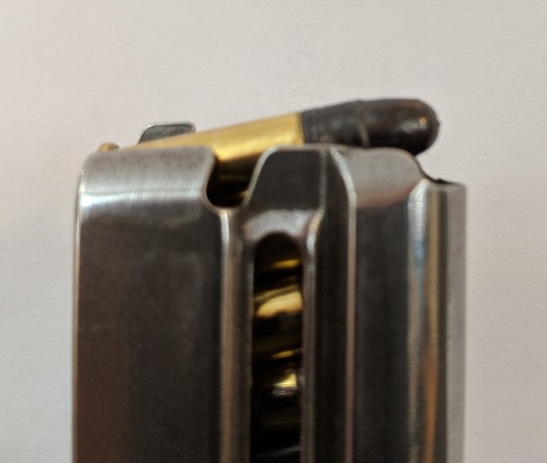

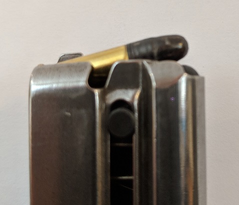

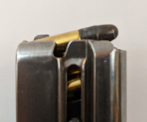

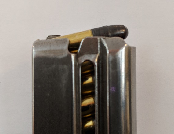

I now understand the problem. It's in the design of the mags, maybe generic to all rimfire mags, but due to the entry into the Benelli chamber, more of an issue for mine.
The top round in these magazines tips up less (i.e. rides "flatter") when the mag is full. The tip-up angle rises quite a bit by the time the last round is ready to feed. This means the first round is especially likely to contact the bottom edge of the chamber. This contact, in turn, can cause it to bump at the top (inside the chamber itself) as it pushes further into battery. Later rounds go straight in, which is what I've been seeing.
It seems to have less to do with the mag lips (i.e. where the round rests as it tips), and more to do with the width of the space at the very back, where the rim of the brass stops. The full stack seems to "pinch" the rim of the round tighter, kind of jamming it into the top of the mag and preventing it from rotating upward as much. As the stack empties, the spring pressure decreases, and the rounds slide up more readily.
Here are photos as the mag empties (SK Pistol Match ammo). See how the tip of the round rises noticeably as it progresses?
Loaded with 5
Loaded with 5
Loaded with 4
Loaded with 4
Loaded with 3
Loaded with 3
Loaded with 2
Loaded with 2
Loaded with 1
Loaded with 1
Now - what to do to correct it? Polish the inside of the mags? Modify the gap at the very rear to force the rims into the upper corner and make them tip? Or is it basically a within-tolerance thing, and simply a result of the mag's shape and design?

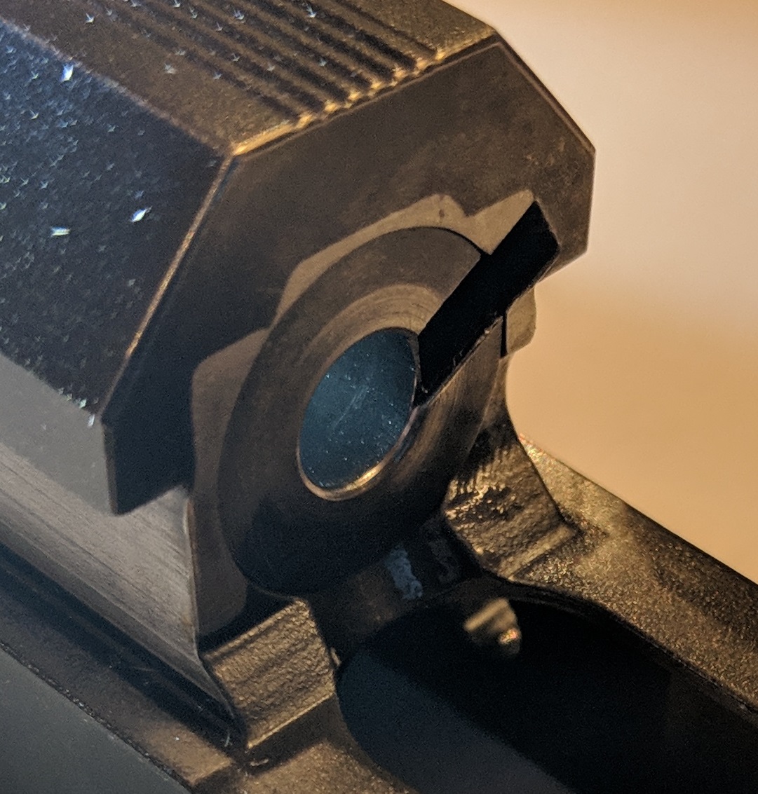

Just a followup with a new photo, showing the chamfering at the edge of the chamber entry. It's pretty much uniform all the way around.
The contact is at 6 o'clock, and the feed issue is minimal if the chamber area is kept clean, however that spot shaves lead and wax over time. Once it builds up to a certain point, around 500-1000 rounds, things definitely start to act up. Yes, I know that 500-1000 rounds in a .22 match pistol is about when I should be cleaning it anyway, but the issue really sneaks up and can hit at any time. So slowing it down to where I'm in charge is important to me.
Note, there's no kind of feed ramp in this gun, either on the barrel or the magazine. So I'm again considering relieving the area at 6 o'clock. Seeing how the gun has become a bit irreplaceable in the US, I'm really torn. Talk me out of it!

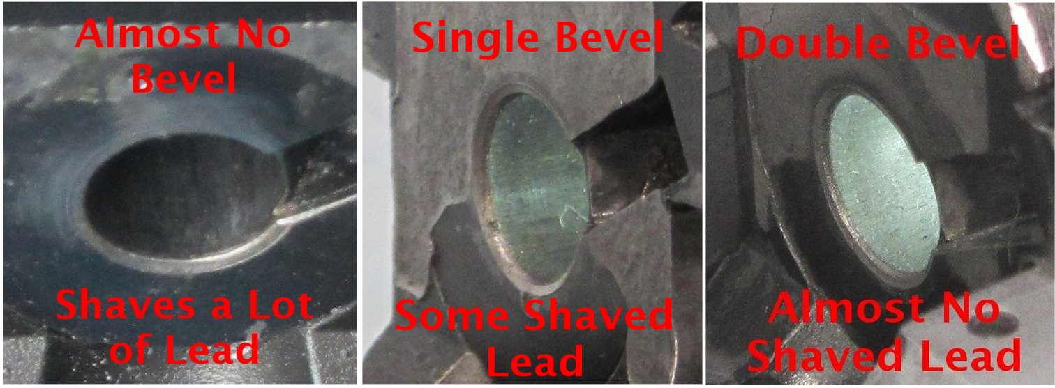

Posts: 3559
Re: Benelli MP90S .22LR feed "contact"
Yours doesn't look too awful, and if you have to clean it every 400 rounds, that's actually not too bad.
Here are photos of three Benelli chambers for comparison. Yours is similar to the middle one, with a single bevel at the chamber mouth, The pistol that shaves the least lead has a roughly 45 degree bevel like yours, and then a small, shallower bevel going inside a bit.
I'd leave it alone, or go at it VERY gently.

Fascinating, thanks! Mine is definitely just a single-bevel, and it seems somewhat sharp to me. But comparing with your examples I agree it's right in the ballpark.
I guess I'll go back to focusing on the mags, and see if I can get those top rounds to sit more consistently. I've tried tweaking the way I start a string, by manually moving the slide forward into battery instead of slingshotting it, and while most rounds seat smoothly, every once in a while they'll still hang up at that edge. This tells me it's not about the force of the recoil spring, or the mags getting sticky. Subtle...

That double-beveled one at the right - what do you think are the angles? The outer one seems extremely shallow, is it possible that the inner bevel is a regular 90 degree countersink, then a (say) 120 degree "on top"?
It seems odd to me that the factory would change this. Is there a big gap in the date stamps (Italian standard two letters in a rectangle on side of barrel frame) between this one and the others? Mine is "CP" - 2016.
Posts: 3559
I think it's more a manufacturing variation than a design change. All of the pistols I showed are at least 15 years old.
If I had to guess, the main bevel at the rear is 90 degrees (45 w.r.t. the breech face), and the inner one is ~ 60 degrees. They may have skipped the second bevel operation as a cost cutting step, or just forgot to do it. My understanding is that Benelli makes shotguns about 51 weeks out of the year. Every once in a while, they switch over production to making pistols. I wouldn't be surprised if details like the 2nd bevel get forgotten occasionally.

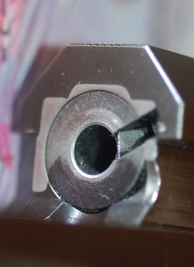

Success! The McMaster-Carr holder extension works perfectly to sneak a tool in from the rear of the frame. It's on the short side so I removed the elevation screw and flipped the sight up to get an extra 1/2".
We:
  • Used a cone-shaped stone to gently add roughness (rotating by hand) to the inner edge of the bevel
  • Polished the bevel (and only the bevel) using a felt bob with 400 compound
  • Cleaned the felt and switched to 800
  • Cleaned again and finished with 2000
Here's the result:
There is *no* trace of a ding on the underside of any chambered round after this. Fairly amazing what a big difference this small change makes.
