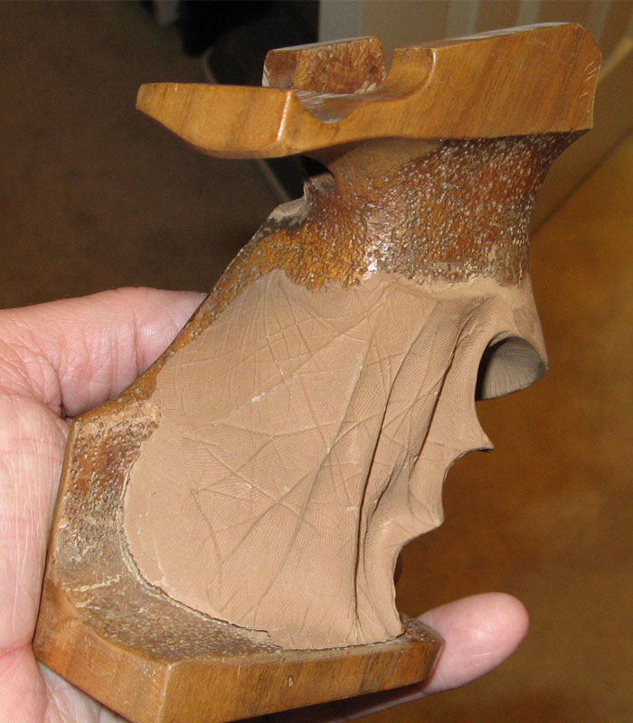

When I had my grip worked on, the guy used a 2 part kneaded epoxy from Ace Hardware. After you put it on, you can work on it (file or grind) after about 15 minutes. Which is good for those of us who are impatient. This is a huge improvement on the cure/dry time of the plastic wood.

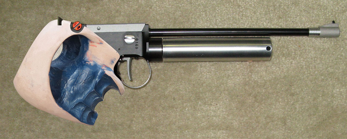

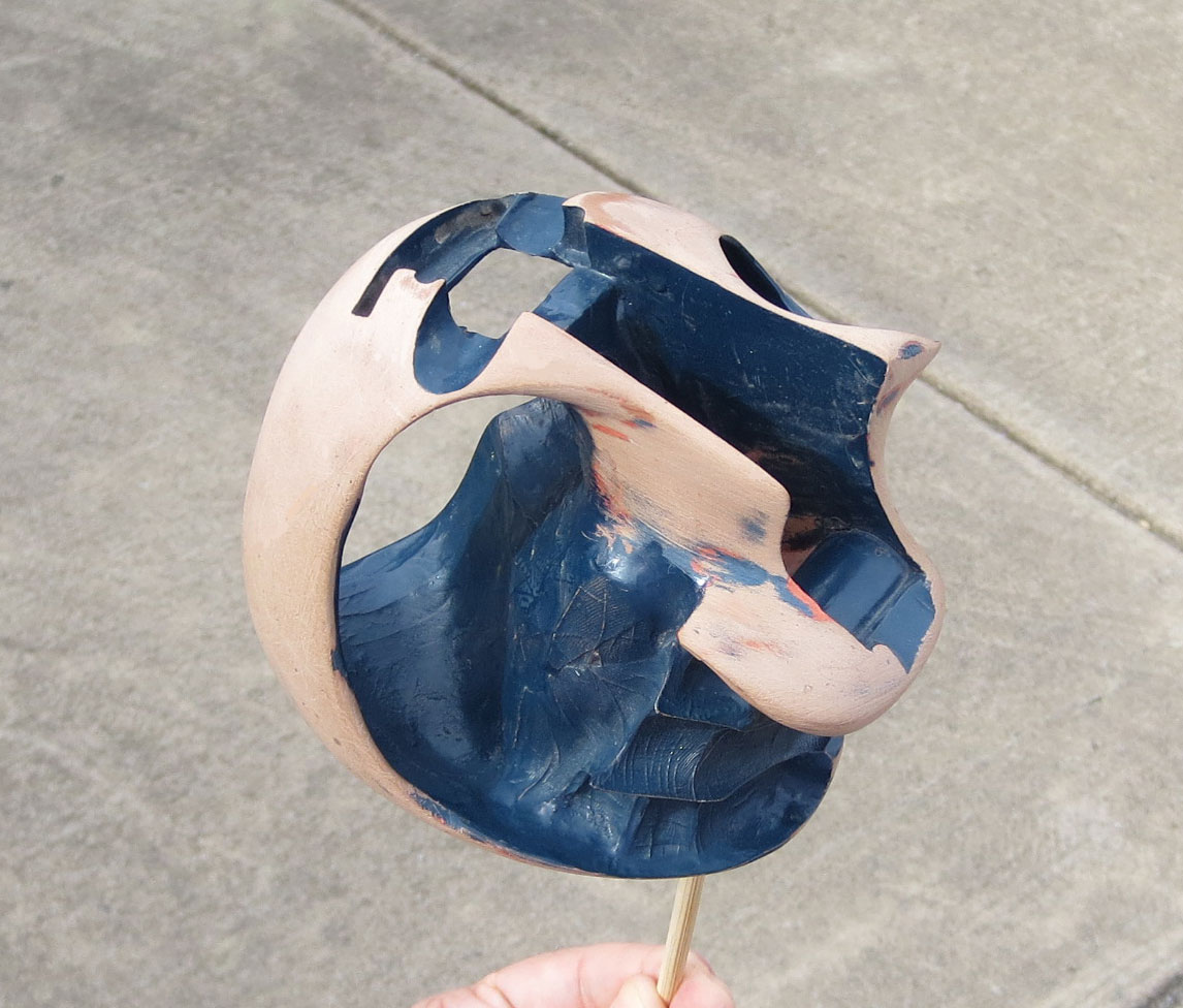

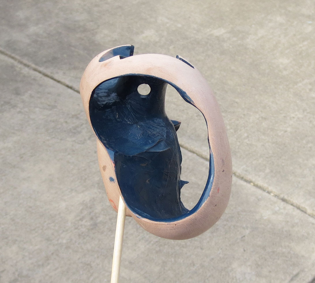

Here is a picture of a complete grip, built up entirely with Tuf-Fil. Start by adding a thin layer around the pistol action, smeared with petroleum jelly as a release agent. Then build up a stem for the hand portion of the grip, then add layers until complete. The material carves, files, sands easily, and accepts paint, etc.

It was built (circa 1990) around a Pardini-Fiocchi K-60 Air Pistol, which I converted for an experimental Air Pistol Free game shot at 10m on a reduced 50m target. The pistol used a thinner diameter, .177 K-58 barrel (10mm vs K-60's 12mm) with an extended blooper tube and muzzle brake. It used a short CO2 cylinder and 20-30 gram trigger. Other than the switch from PB to pellet game and a new target, all other FP rules applied. How's that for thinking outside the box? Picture below...
