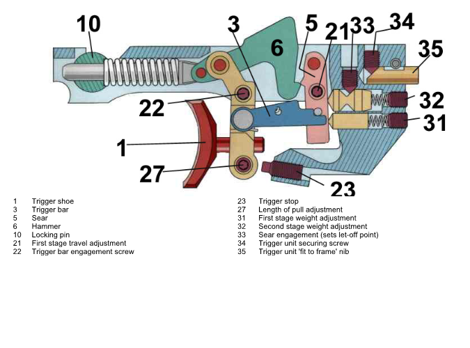

hi @Gwhite (or somebody else)
do you per chance have a similar trigger setup instruction diagram for Walther GSP 2 starge trigger?
i have the parts diagram
, but i don;t know exactly how to adjust it properly.
the way i managed to set it up it feels... mushy
Posts: 3547
Re: Pardini SP Trigger Adjustment Diagrams
I have never taken a detailed look at the GSP trigger. It is a VERY different mechanical design from the .22 triggers I'm familiar with (which are all Italian, and use a spring loaded ball inside a screw for the 2nd stage).
I'm also not sure what a "mushy" trigger is. 1st stage or 2nd stage? As a guess, I'd A) make sure everything is clean & lubricated, and B) see if adjusting #33 helps.
Posts: 1709
The principal is just the same, 1st stage travel and weight, trigger point with 2nd stage weight.
It just uses a different way of adjusting with angled cones and screws.
The adjustment is a lot coarser and needs fine setting with a very clean trigger assy.
One caused me a lot of pain years ago with varying settings due to offset ground screws.
21 - Sear engagement, Sets sear engagement and total trigger travel.
22 - Trigger bar travel, sets clearance on transfer bar to allow trigger re-set.
23 - Trigger Stop. Sets trigger over travel,
31 - Ist stage weight
32 - 2nd stage weight
33 - Trigger point, this sets the position that 2nd stage comes into effect.
Best way to set is to load up screw 32 (2nd stage weight) so that you can feel it heavy.
Cock the hammer and gently pull trigger aft to sit on 2nd stage weight point.
Then slowly turn 33 "in "(clockwise) until the hammer falls.
This establishes the trigger point position. Turn screw 33 "out" 1/8 to 1/2 turn for trigger
2nd stage travel feel and then set trigger weights both 1st and 2nd stage.
