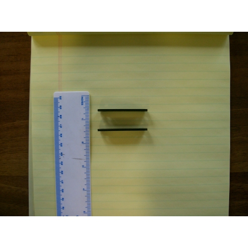

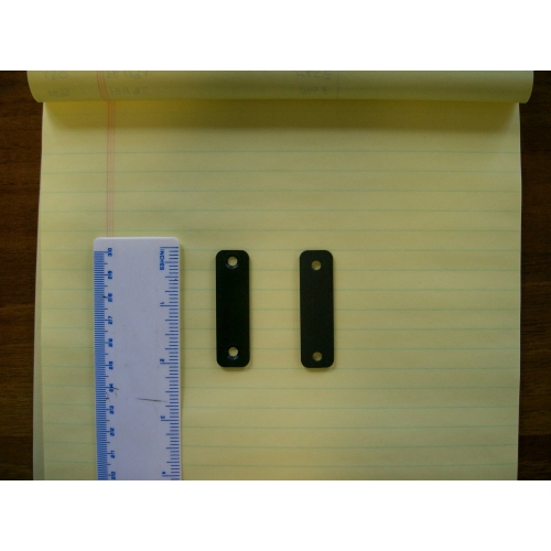

Cesare designed the two holes on the slide cover as for counterweights as for weaver scope .
The counterweight are two steel plates of 10 g/each.

MG2 internal counterweights
Post by kalz »
In attachment the pictures of the internal counterweights art.2064
Stefano
