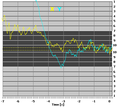

Here's a plot of a good shot from a Noptel system (competitor to SCATT, no longer around):

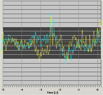

The pistol comes down, settles and the shot breaks about 1 second after the hold really stabilizes in the 10 ring. Here's a bad shot:
There's no telling how long the approach was before the trace started, but the shooter is settled into at least the 9 ring about 4 seconds before they finally fired. After that, their hold deteriorates badly, and they ended up with a 6. Yes, you can guess that maybe you held too long, but an electronic trainer can really show you the details.
