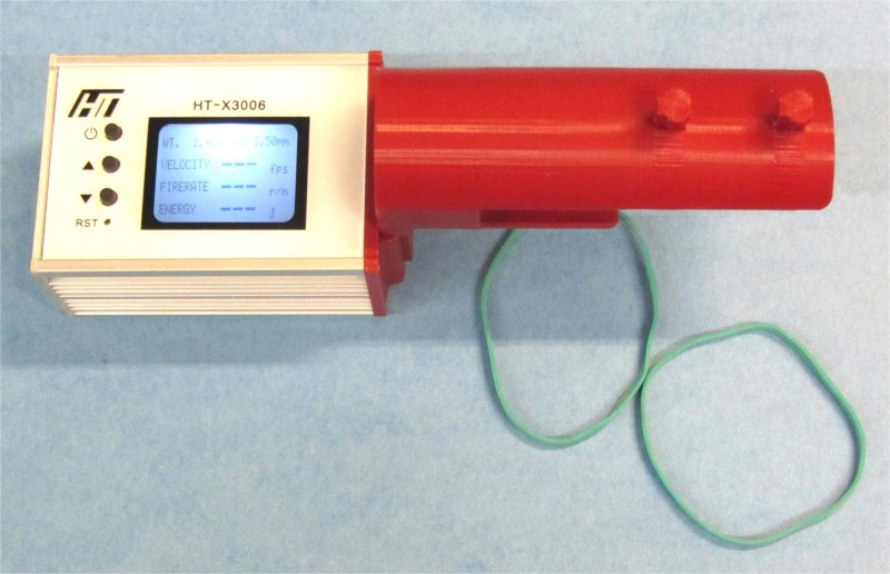

They attach with brass pins that can be arranged to suit your muzzle diameter, and then those are clamped to the muzzle with rubber bands or a zip tie. If you only have one pistol to work with, that's fine. I have at last a half dozen different makes & models to deal with, so I'm working on designing and 3D printing adapters that attach with a dovetail arrangement. The only minor annoyance is that if you want to be able to use your sights when you fire, the box has to be mounted with the display pointing down. I've got an adapter designed for Benelli Kites, but I don't currently have a Kite at home to get a good photograph. I'll post a picture or two in a day or so.

I just realized I never got around to posting photos of the 3D printed mounts I'm working on. I've replaced the end mounting plate with one with a dovetail to accept different adapters. Here's a picture of the chronograph with the end plate and a Benelli Kite adapter:
Here it is installed on a pistol:
HT-X3006 Kite Mount (sm).jpg (46.54 KiB) Viewed 45114 times
And here is the chronograph with an adapter for Morini 162EI pistols:
HT-X3006 Morini Mount (sm).jpg (36.66 KiB) Viewed 45114 times
I have adapter designs printed for Steyr LP10's, and Hammerli 480K's. I've got one in the works for Anschutz LP@'s, and I will also be developing one for Hammerli AP20's as well. Once I have them all finalized, I'll park the files on Thingiverse.

If not already there, is it possible to emboss the model number somewhere on the adaptor as part of the design?

They are labeled. I'd never be able to keep them all straight otherwise...
One issue I haven't investigated is that I may need two different ones for Hammerli 480K's. I think half the ones we have were converted from 480's (no "K"), and the spacing between the barrel & cylinders is different from ones that started out in life as 480K's. The original 480's had a very bulbous carbon fiber tank.

The models were mostly created from one or two pistols, so with manufacturing variations, there may be some tolerance issues with the fit. I will provide STEP files as well so they can be tweaked, but I'd also like to get feedback on any serious issues. I think I will probably have to make two models for the Hammerli 480/480K's, because I think the cylinder mounting height was changed between the two variations. I want to check that soon while the design approach is fresh in my head.
Posts: 3529
Re: New Inexpensive Air Gun Chronograph
All the models are posted to Thingiverse, including STEP files:
https://www.thingiverse.com/thing:6977381
Current pistols supported are: Anschutz LP@, Benelli Kite, Hammerli AP20, Hammerli 480K, Morini 162EI and Steyr LP10.
