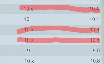

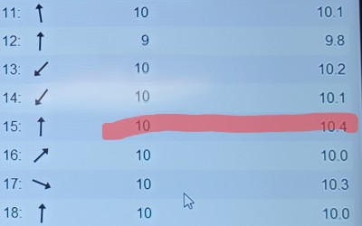

When there is a tie in qualifications, the FIRST method of breaking it is by quantity of inner tens, which in paper targets are easy to see because they are on the target, and on EST represent a shot whose value is over 10.4.-

The standard air pistol configuration of the SIUS electronic target system we use produces results that include "10" and "10x" for shot values. This is actually a pain in the neck, because we have to report the match results to SASP in a spreadsheet as 10's and X's separately. I had to write a routine to convert all of the "10x"s (which the spreadsheet views at text) into numerical 10's and also add up the number of X's.

The "X" ring (Inner Ten ring) or 11 ring as you call it was introduced as a target change in 1989.
Currently on paper and EST target it used as a tie break if you do not have a final.

The annoying thing is that the Xring, does not coincide with 10.5 (Correct me if I'm wrong).

Yeah, the X ring for air pistol is somewhere around 10.41 or 10.42. It doesn't exactly correlate with any decimal score.
