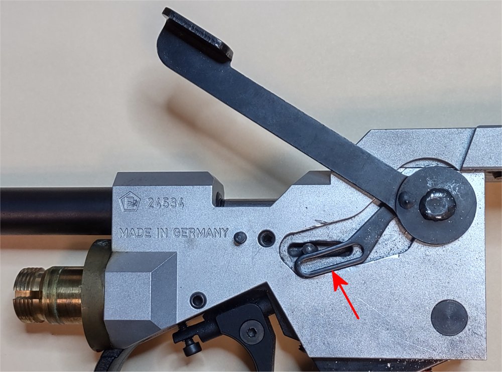

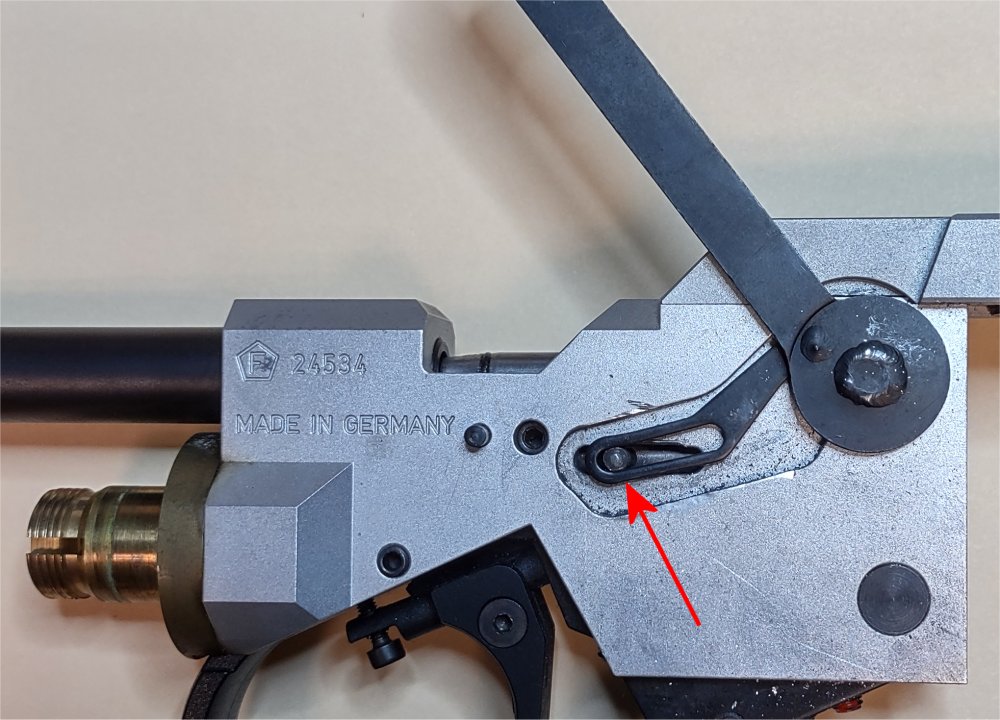

Thanks! Now that I know 7 or of 8 cylinders are somewhat functional, I'm mostly looking into the other issues. The reason I couldn't close the bolt is that the cocking lever linkage under the grip wasn't in place properly when the grip was installed. Somebody who wasn't very careful had clearly been poking around internally at some point.
The cocking lever now closes the bolt, and I can feel it compressing the firing hammer spring. I put a filled cylinder on the pistol, and the firing valve holds pressure. However, the trigger still flops around, and the sear isn't catching the hammer. It may just be an adjustment issue, or something could be busted internally.
